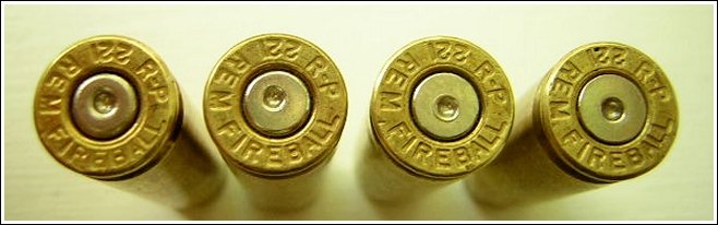

If you work your loads up slowly, they will usually show an increasing flattening of the primers, like this:
However, as your handloads get hotter, they don't always increase as uniformly as shown here. Sometimes you'll see one or two that looks slightly hotter (with a flatter primer) than the others. Just be sure to increase your pressure slowly and when you get a few cases that look like number 4, you're at the maximum load. However, if you don't work up slowly and a round looks like number 4, it could be way too hot.

Innovative:
HEY! The .221 Fireball. Was just reading up about the cartidge. May have to add one to the stable sometime (instead of a .223 :eek:)!
The way I see them is none of the four show a "maximum" load!
A factory load in the 308, 270, or magnum class of cartridges will likely flatten the primer to a greater extent.
The 221 Fireball cases (pictured above) are actually necked up to 30 caliber making them into 300 Whisper. The case on the far right definitely is a maximum load, and ANY rifle caliber that flat should also be considered maximum.
If you see primers flatter than case number 4 you're dealing with pressure that is beyond a "safe" maximum load. In fact, as I mentioned ...... any case that looks as flat as number 4 could be beyond maximum if it wasn't developed slowly up to that point. In other words; if you added an extra 10,000 PSI to case number 4, it would look the same.
- Innovative
[Case number 3 was actually fired in a different rifle with a smaller diameter firing pin. That small crater doesn't mean anything.]

That's just about the best sequence of photos on the subject of primer-flattening that I've seen - thanks.
It would be better if it started with a weak load that showed a primer that had been pushed out a bit, and ended with a couple more that showed some further flattening and a bit of burnishing on the brass from the extractor groove, but they relay the message nicely.
I still find primer "pressure signs" very deceptive and unreliable, except for the under pressure (pushed out primer), and extreme over pressure (blown primer pocket) indicators. The in between signs are affected by too many variables such as brass and primer qualities (softness or hardness), and bolt and chamber smoothness for example.
I believe that a load book and a chronograph remain the best pressure estimators for the average reloader, short of the kind of pressure testing equipment that none of us are inclined to purchase.
Andy ......
I agree that the load book definitely is the best place to start, and the chronograph is a great tool for performance testing. However, primer signs (as shown) represent a typical "starting load" increasing in pressure toward a maximum load.
The hardness of primers does vary, but not nearly enough to effect the high pressure inside a fired case. Reading fired primers is the best (and most widely accepted) method for evaluating chamber pressure. For a variety of reasons, every chamber can produce a different pressures. Examining primer shape is the best way to test your particular handloads in your particular rifle. The picture is a good represenation for any rifle caliber.
