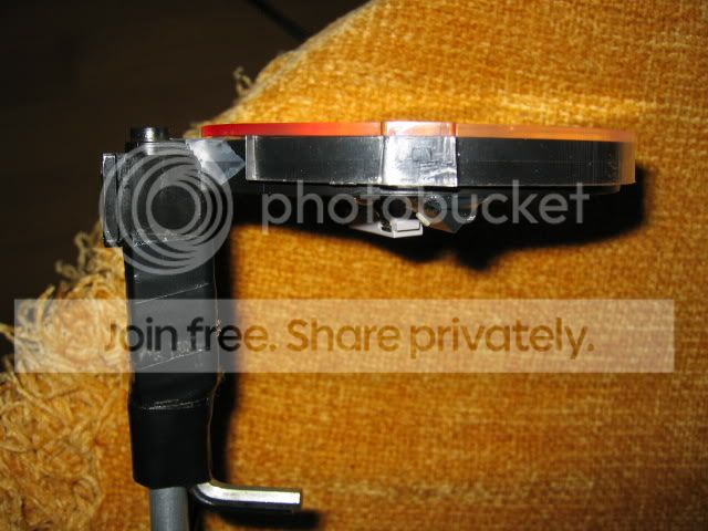

I built one out of a Lee AutoPrime and a buzzer from an old cell phone.There are a few around that use the lee primer trays with a vibrating adapter to drop the primers down the tube. Nothing commercial thought. There used to be a Frankford Arsenal??? plastic unit that isn't sold anymore.

I beg to differ. I don't need to shake, the cell phone vibrating motor does that for me. I don't have upside-down primers EVER. I would get an occasional primer stuck on its edge, but just flipping it back into the tray fixes that.I've seen people using the Lee Autoprime with not a very good results. They have to keep shaking the Autoprime and only a few primers will drop freely, then keep shaking shaking. Primers will flip upside down once in a while if you just not paying attention for a second.

??? The Lee based one in the video worked pretty slick......
