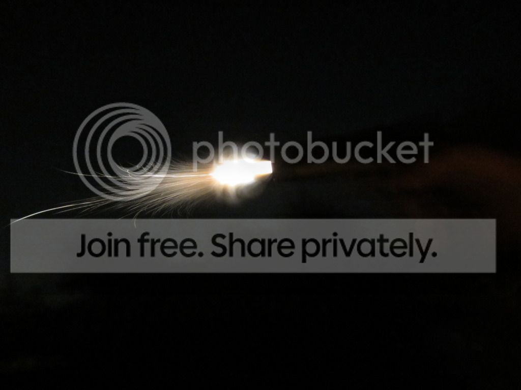

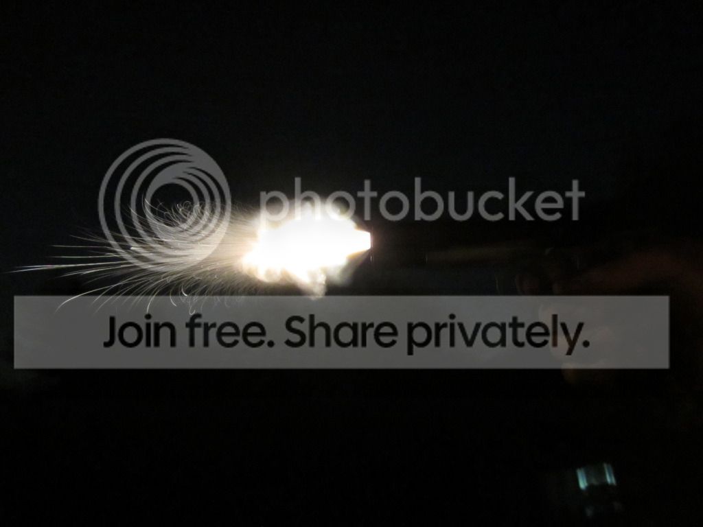

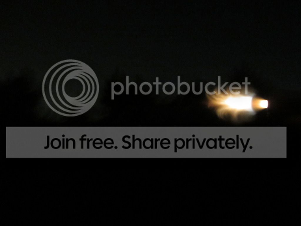

I tested primers in the dark, so I could see the difference:
CCI Large Rifle
Wolf Large Rifle
Winchester Magnum Rifle
