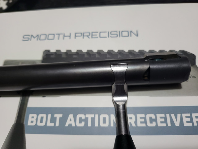

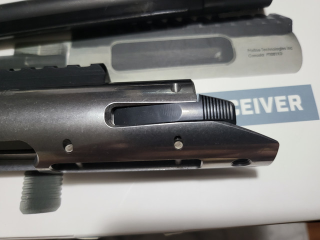

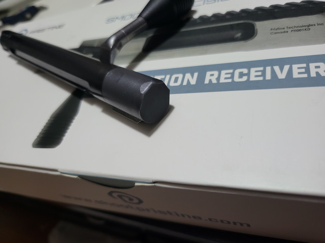

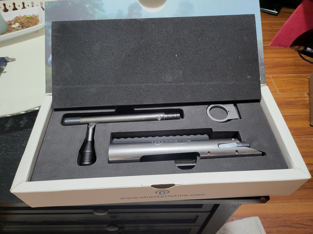

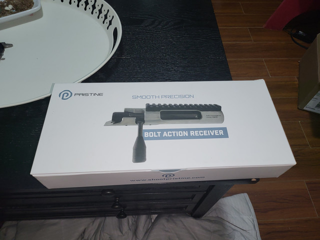

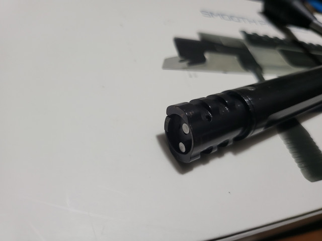

Bought for an all Canuck Rifle
Pristine Action 700 SA foot print 308 BF c/w 20 moa rail and lug
6 lug, 90deg throw, dual ejectors, sako extractor, roller cocking piece, interchangeable bolt heads, 20 tpi...takes savage style bbl nuts. Priced very well.
Trigger Tech diamond
IBI BBL
MDT ACC
Happy with the initial out of box review. Smooth like they say.
Packaged well.

I'll stick it in a few stocks tonite to check fitment. I like ability to change rails...recoil lug integral would have been nice. The 90 bolt throw...cocking is very easy and smooth, all on open. Feels a bit lighter then my tl3.
Lugs are cut to same diameter as the bolt...guessing this adds to how smooth the action runs. Will have to see how it handles under match conditions. Waiting on a bbl nut but I'll throw in a stock and do some testing
Agreed, looks basic and based off pics and vids of mfg process I’m iffy. Also why need 6 lug? For the calibers offered, these ain’t no 50bmg

I picked one up about a month ago and it seems smooth enough and I like the fact it fits in 700 stocks as well as 700 triggers, they are well priced and do have a pinned lug so swapping barrels shouldn't affect bedding.
It would be nice to see a long action as well as a magnum bolt head but not a deal breaker for now , I like the sako extractor and the way the diameter of the bolt would seal gas from a case failure and no way the extractor could blow out because of it
