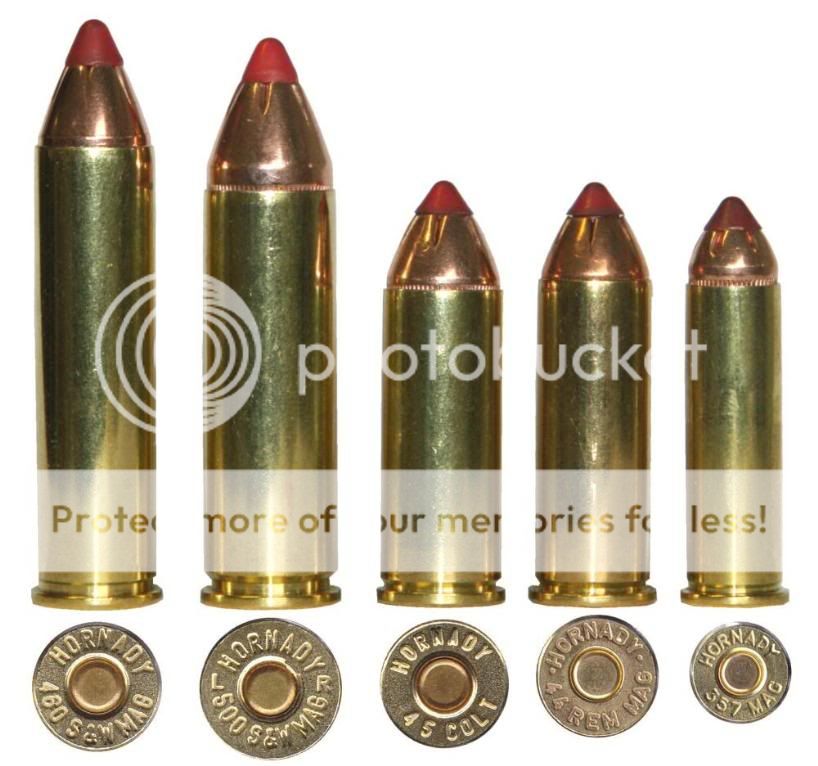

In between American eagle 240 hp (Only one that works) Fiocchi 240 sjsp and Hornady leverevolution 44 mag 225 gr

Its what I figured from the very beginning , but the whinchester and american eagles projectile is pretty much the middle ground on bluntness, fiocchi being slightly bigger, and hornday stuff being small, much smaller.
Hornady leverevolution.
