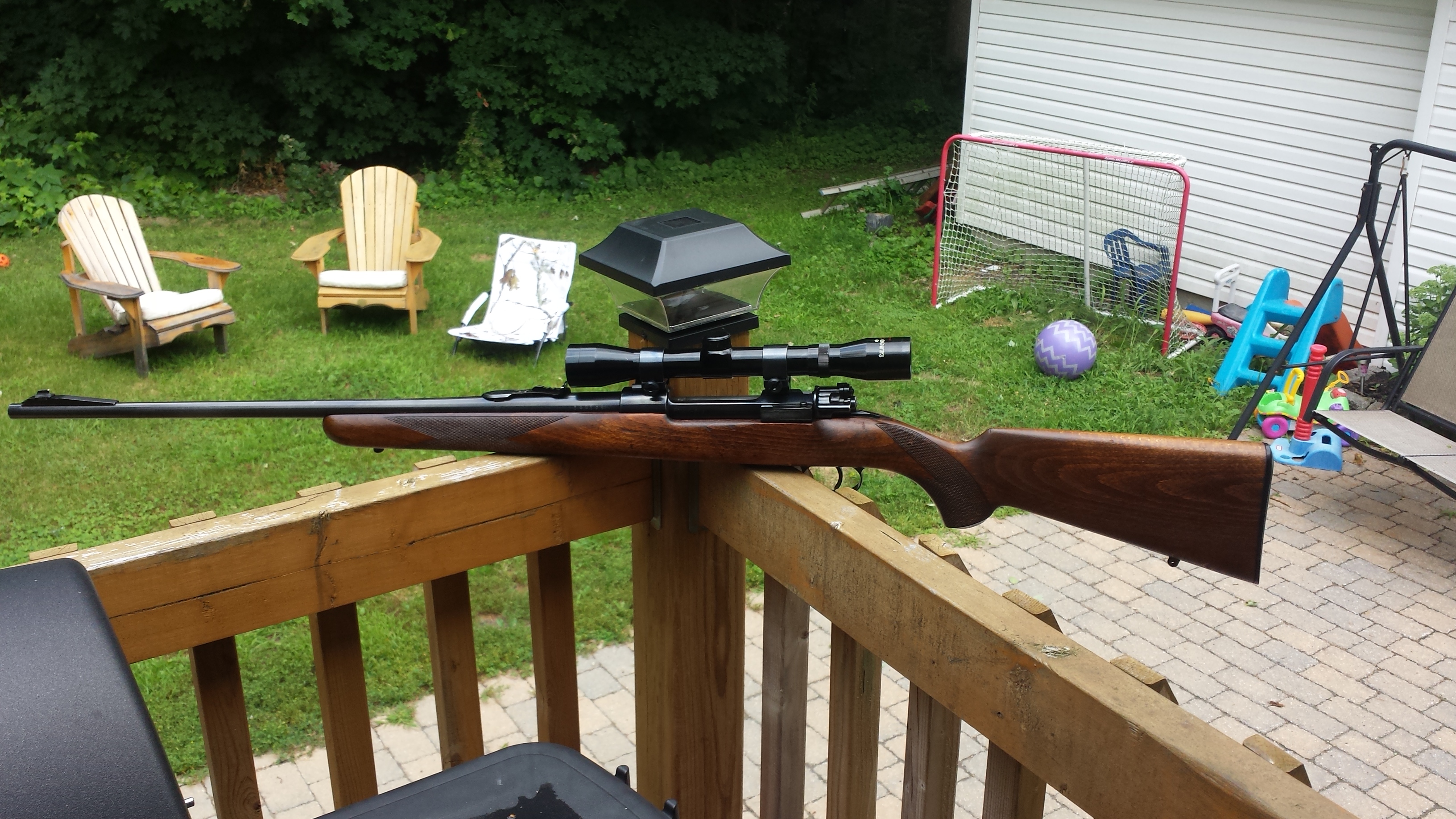

So, I have a Husqvarna 640 that's built on a FN 98 receiver. I ordered the weaver bases for a FN98 which are #45 rear and #46 front.
I installed them, and then I noticed that they aren't at the same height. I tried a pair of Leupold PRW rings and the heights between the two are different. I'm not sure exactly if the #45 rear is meant for a military Mauser with a charger groove? Any help appreciated.

Here are a few 98's, yes the rear looks high, but that's the way it is.
I did lay the scope down and the front end tilts down, hence why I posted this question. I don't want to crush the scope :S

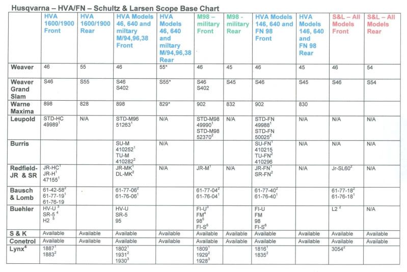

So the 1640 uses #46/#55 and a M98 uses #46/#45. I'm not sure about why I have #46 and #45 yet the scope ring heights are not even close to one another. I scoured the depths of the internet looking for people with similar issues, and I came across both large and small ring Mauser 98 receivers. Yes, not a Pre-98 model small ring mauser (93, 95, 96 etc.), but actually Model 98s with different receiver ring sizes. And apparently the Swedes did use a smaller ring variant, so perhaps why the #46 is too high as it's meant to match up with a large ring 98.
Within this thread, Baribal, our HVA guru states that the 1600 series rear receiver shares the same dimensions as the 640 (FN98) action. So that's why I'm leaning more towards the same #55 base to get lower height.
https://forums.gunboards.com/showth...-Chart-Apeture-Sights-Updated-January-15-2011
640 came in '96 and '98 actions, depending on the year of manufacture.
A '96 640 would use the same 2 piece bases as the 1600 series.
A '98 640 would use 2 piece bases for any commercial '98.
It shows them both in your chart above as well...640 '96 and 640 '98.
