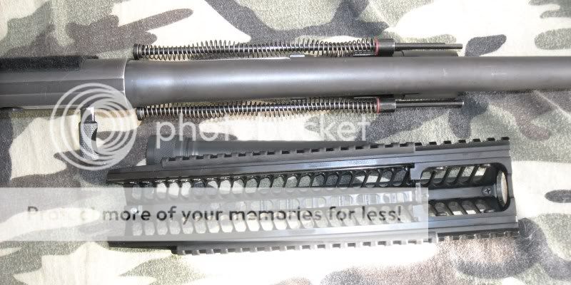

The ETA RSS system just gets rid on the recoild spring in the butt stock and the rat tail on the back on the bolt carrier.
Its is really easy to do the change over if your even a little bit handy.

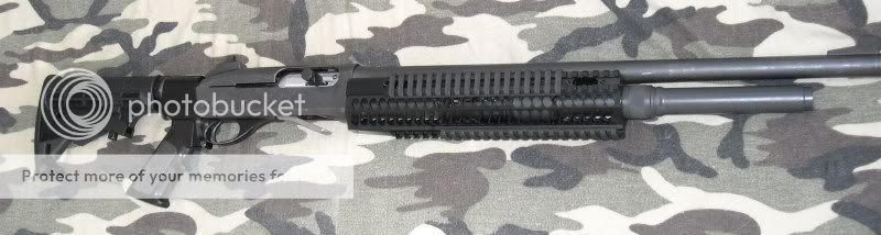

looks like the eta rhine rail from s&j hardware
I think so too:
http://sjhardware.com/store/modules.php?name=catalog&file=product_info&products_id=361

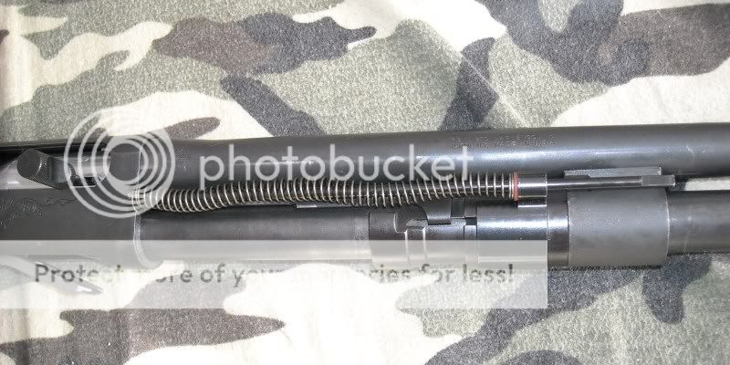

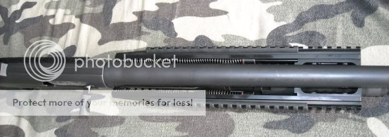

Pics below copied from a thread by badboybeeson
[/QUOTE]
