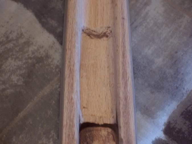

I decided that I was now ready to prepare the stock for glass bedding and the pillar bedding. The first thing I did was make sure that I knew what I was doing and after making sure of that, I prepared my materials. I would first start by getting the barrel channel ready for the stock by scraping out wood. Then I would get the rear of the stock ready and then I would get the pillar ready after that. My materials that I got ready were: A drill, sand-paper and a chisel. Unfortunately I do not have many tools so I was limited to what I used but I think a dremel tool would work great for a lot of this. Since this was my first stock ever glass bedding or pillar bedding I was not quite sure of how to do it completely right but I went ahead and did it. First, I made a small channel about 1/8” deep for bedding about 3 to 3 ½ inches long in front of the barrel lug. I found that the chisel worked well for getting rid of some of this wood. I made the cannel about a 1/8 of an inch deeper than the surrounding wood. I dug out the sides a bit as well all the way up to about ¼ of an inch away from the top of the sides of the stock.
Now that I was done with that, I went ahead and started to make my channel for glass bedding at the rear of the stock. I wanted the channel to be about 1/8 wide and about 1/8 deep but not having any proper tools to complete this, it turned out to be a bit deeper and about ¼ wide. The channel does not have to be completely strait, it can be at a bit of an angle. I found that I had lot of trouble getting the drill bit in the area that I wanted to bed but after a bit it got easier and I finally got it done. The area that I did with the drill turned out to be a bit “zig-zaggy” but I thought that this would be fine. I made the channel at the rear of the receiver (shown in the pictures below) and extended it about ¾ of an inch to an inch, up the side of the receiver. For extra support, I also made a spot about 2 inches up from that about ¾ of an inch long, also seen in the pictures below.

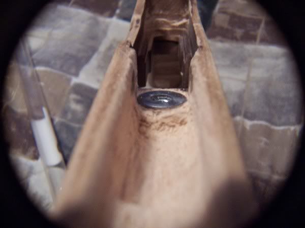

Next step was to prepare the stock for pillar bedding. Although this would seem to be the easiest step, I found it to be one of the hardest because I did not have any proper tools. I was originally planning to use a normal ¾ inch (diameter) by about 1/8" or 1/16” thick but I accidentally made the hole a bit too deep for It so I was forced to use something else. What I finally did was found a washer and a nut and glued them together (glued the washer on top of the nut. The washer was larger in diameter than the nut but it all worked out). This set up worked good for the pillar.

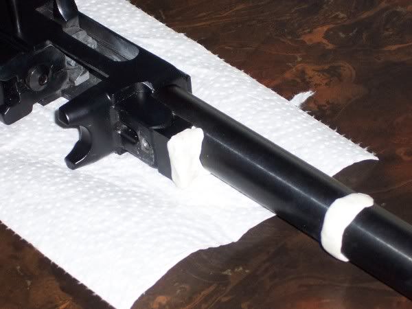

My next step was to put modeling clay around the area where I was bedding to make sure that no access bedding would get onto the wood or into the v-block area. I put clay on the v-block, on the other side of the bedding channel, and a little on the underside of the nut and washer that would be used as a pillar. Now that I was confident to start.

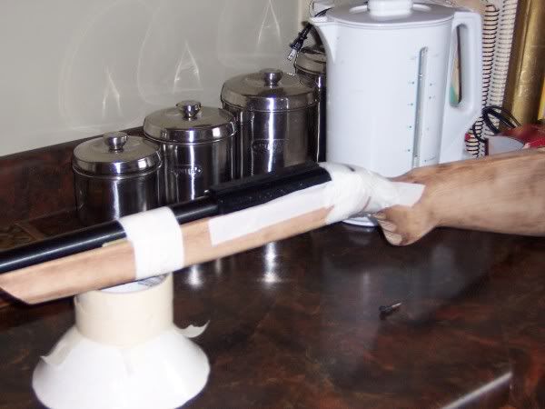

Since I had a lot to bed, I made quite a bit of bedding material. I mixed about one and a half tablespoons of each material and gave it a good mix for about 3-4 minutes. After I had finished stirring, I went right ahead and applied the material to the bedding channel. I also covered my pillar in epoxy and put it in the hole. Next, I put the barreled (receiver and barrel only; not the trigger or bolt) in the stock. When I pushed down on the barrel there was some epoxy that had squished out so I snugged the take-down screw and left it.
After about three and a half hours I decided that I would take the barrel off and check to see if everything was going all right. I first tried taking it off and thought “wow” it was sure tight, but after I dropped the gun on cement from about 1/8 of an inch off the ground, it came out (still with some difficulty). Everything looked ok (except for a few cosmetic problems but I was not too worried about them) so I tried putting the barrel back into the stock
The next morning, I got up and started right away to start working on the project. I removed any excess clay and release agent off of the barrel and stock with tooth-picks and to remove the release agent, I just used my nails to peal it off. After cleanup was done,

I put three coats of release agent on to (and inside) the receiver. I also filled the trigger group pins and bolt buffer with modeling clay. After that was done, I mixed up my acaraglas gel and tried my best to fill all the holes that I had dug out. I ended up filling the holes and spreading it across where there were no holes as well. After that I put the receiver on and put tape around the back of the receiver and around the forearm of the stock and the barrel and waited for about four and a half hours for the bedding material to dry a bit so I could check if everything was alright. It was fine.

After all this was complete, I put the action back together. To do this I first cleaned off the inside of the receiver and then I began to put it back together. To do this I first put the rod back and the bolt handle back in. Once that was done, I pulled back on the handle and the rod until it could not come back anymore. I held the rod in that position and put the bolt carefully in and pushed it down into its “slot”. I then moved the handle back and forth to check if it was working all right and sure enough it was. My next step was to put the trigger group back in. I first put in the front pin; to do this I slid the bolt back and held it there and pushed up on the trigger until the trigger pin holes lined up. I put the front pin in and then after that I put the rear pin in. After this I reinstalled the bolt buffer and put back the magazine. I was now done putting the action together. You may want to do this whole process again to fill in any holes or gaps that you missed the first time. This should make the action/barrel to stock fit even tighter.

I am not quite finished the project yet. I want to go back and re-glass bed it to fill in some of the gaps that i missed before.
As you can see, its not the nicest looking glass bed job in the world but it worked so i am happy
