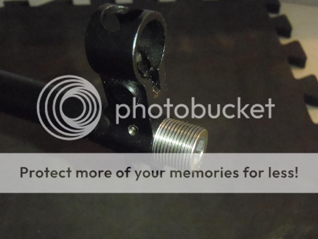

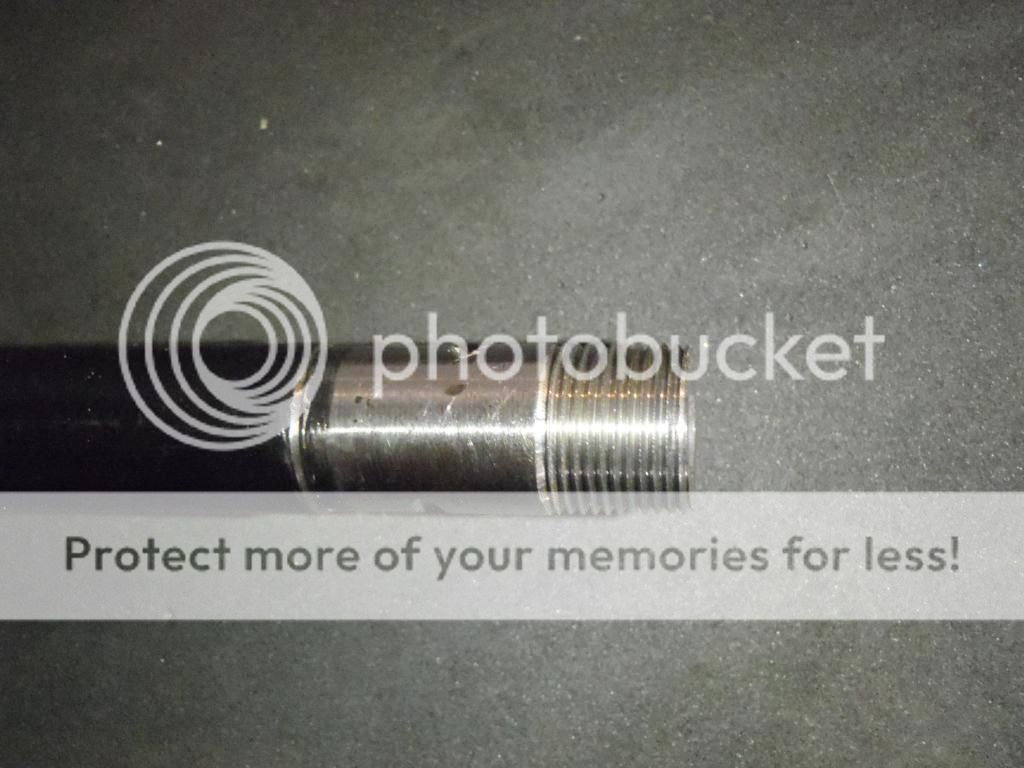

I pulled the FSB today to turn one more thread on the muzzle, so the threads reach all the way to the FSB. Pretty happy with it so far :)

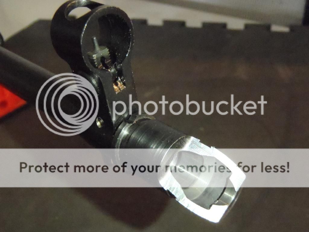

The tendency is for the rifle to jump upward and to the side of your strong shoulder during recoil. Shooting right handed, the rifle jumps up and somewhat to the right. Having the comp angled to the right pushes the muzzle back to the left and down so the muzzle travels less off target. At the range yesterday it was quite enjoyable to shoot, jumping far less than it would with a bare muzzle. Its still no battlecomp or FSC but a big improvement for such a tiny, simple little device.
If your support hand is your left, would you not want to have the compensation pushing downwards and to the right?
It just seems to me it is angled off to the wrong side....
I may be wrong (I often am) but I was under the impression that the reason for the offset on the AK slant brake was to compensate for the rotation of the bolt as it cycles. As the SKS has a non-rotating bolt, shouldn't the brake be aligned at 90[SUP]o[/SUP] to the barrel?

Its definitely not for the rotation of the bolt, installing it straight up is wrong and will result in violent overcompensation. I explained it in my previous post.

If what you state is correct, and it may very well be, then why do conventional (ie not slanted) brakes have ports cut at 0, 90 and 180[SUP]o[/SUP] to each other? After all, an SKS is just a semi auto bolt rifle.
As far as I can remember, the slant brake for the AK was developed as the rotating bolt caused the rifle to twist when fired in full auto.

The slant brake is all about compensating muzzle rise when emptying your AK magazine with one trigger pull. Without the brake, during automatic fire, the rifle would have a tendency to climb up and left or up and right. (Depending if you're a righty or lefty) Nothing to do with the rotating bolt.
Its simply a function of design. The Slant comp directs gas in one direction only, and thus produces a force in the opposite direction. Remember, it is as simple as muzzle devices get. Newer designs direct gases in multiple directions to accomplish different goals. Two opposing ports 180 deg. from each other will cancel each other out as far as applying any force but recoil is reduced as that gas is not creating the thrusting force that makes up a lot of recoil. Angled ports, like on top of the Czech VZ-58 brake are for compensation to keep the muzzle down and help prevent side movement while the side ports reduce recoil. The slant comp simply applies one force in one direction to directly counter what happens during recoil. It pushes in the opposite direction the muzzle is trying to go to help keep you on target.

One of the few "modifications" I've ever seen that actually improved the rifle in any way vice just making it look ridiculous.
Well done Sir.
I like the "Excess Trigger Pull/Quick Reset Mechanism C1A1" as well hahaha Simple and efficient, the Soviet Approach so to speak :rockOn:
Thanks Trav, you hit the nail on the head with the Soviet approach. I wont do anything to the rifle that might reduce its reliability like the gas tube mod, or increase its weight/size unneccesarily. As its sits the rifle is 39 9/16" from buttplate to tip of the slant comp. I bought 4 Tapco mags but was unhappy with them so Im sticking with the original. Luckily a buddy of mine bought them off me for exactly what I paid, which is still a great deal. He wound up getting 5 Tapco mags for $200 and I didn't lose a dime! I'm also doing the mods on his rifle as well, he's been very inspired by mine especially after shooting it.
