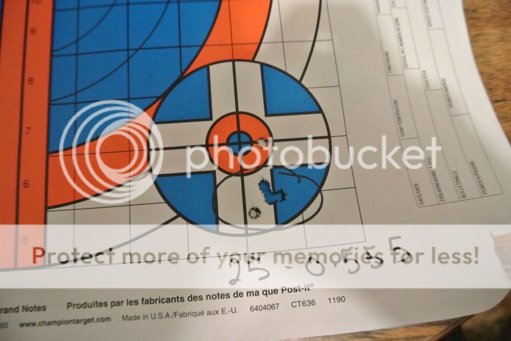

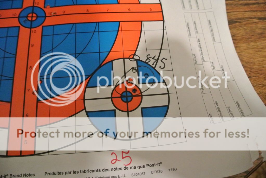

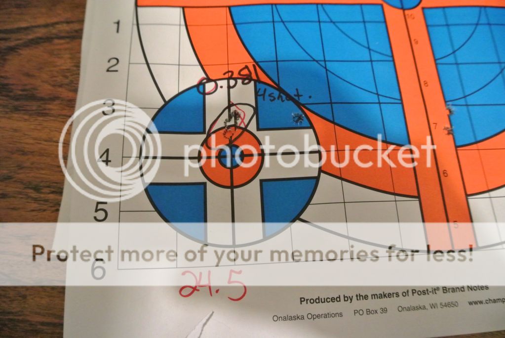

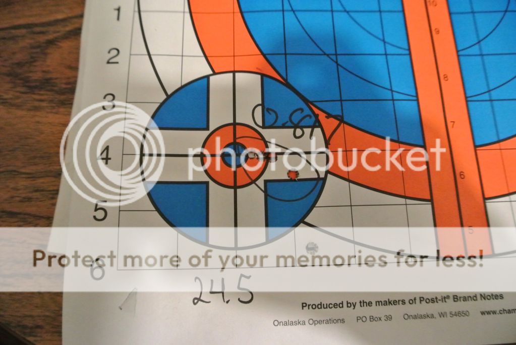

Today was the first day I was able to get out to the range without the wind blowing like mad.
Here was some of the results. All shots were at 100yds from a bench using bags.
Honestly I was going to be ecstatic with anything that was sub MOA, especially on the first time out. I didn't count a couple of the Flyers because those were caused by the loose nut behind the gun. Also would appear that the gun likes 24.5-25gr of CFE 223. I was using remington brass and 70gr berger VLD. I also have some 77gr berger OTM to try out.
So to say I'm happy with the results is an understatement, and couldn't wait to share the results.
