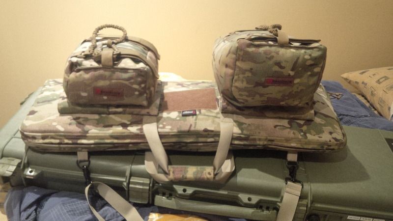

Finally went and got my fatbags and carbine case. The large bag is pretty damn large, already just sitting around the house and using the bags my aim was much much more steady. I can really see the benefits of having large bags like this for barricades and such. My first match can't come quick enough!!
