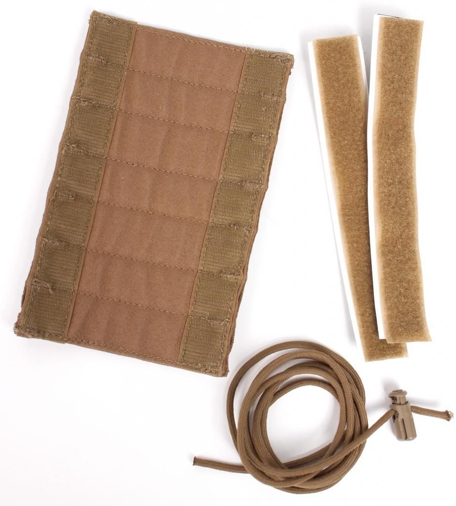

something like that from triadtactical cordura with a bit of padding able to be laced up.

I don't particularly like the gross grain securing loops on most of those pics... they look easy to rip off from over tightening... I think i would sew in individual loops secured between the layers of the pad. make them continuous from side to side so the cross force isn't going to rip anything. Use some felt between the layers for padding,

Never, ever had an issue or complaint about the side loops ripping off from over tightening. We have military and LEO personnel using these rests.We use the proper industrial sewing machines and appropriate thread.
ok... I'm just giving my take.... I personally don't like how you have the the gross grain for the para cord.
I foresee some numptee reefing it tight and pulling the threads till the point of failure; it puts a lot of force on very few threads.
Although it's probably easier to tighten without the cordage hanging up then with conventional loops

daisy chain is meant for a vertical load not a horizontal.... its meant to pull against the whole thread line not specifically against a single thread on the side. if you side load a daisy chain its going to pull at the edge, those pads may last... but ultimately the failure point will be at the connecting stitches (either breaking or pulling out) on the gross grain for the lacing.

Personally, I'm not a fan of something tightening down over my barrel after the first couple inches from the action. There is a version of skid pad that is sold in the US that fastens to the rifle with laces or velcro (either is optional).
These things are usually made from a rubbery material that grips vs. cordura which slides.
I made my own that fastens the same way. I got a 3'x3' sheet of 1/4" neoprene foam (which also grips) from the local surplus store for $1. I got a pack of sticky velcro from Dollarama for another $1. Enough to make dozens of skid pads.
Been using the same one nearly a year. It's been to three PRS matches so far and has never come off at a match or during practice. It's only starting to show some wear and it's been used on all manner of barricades and rocks.
