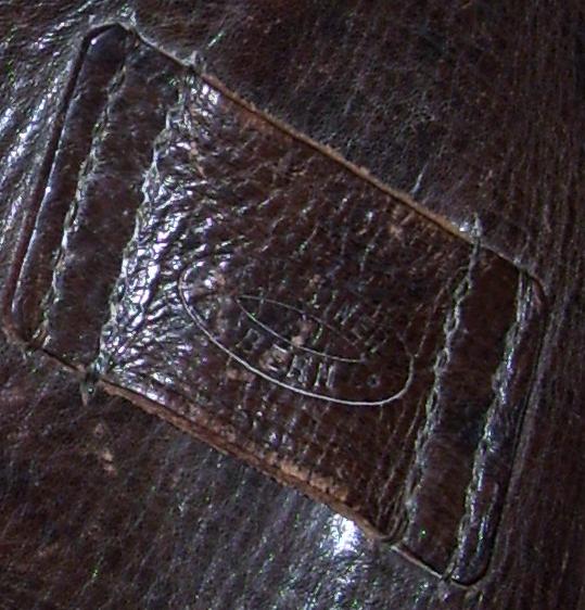

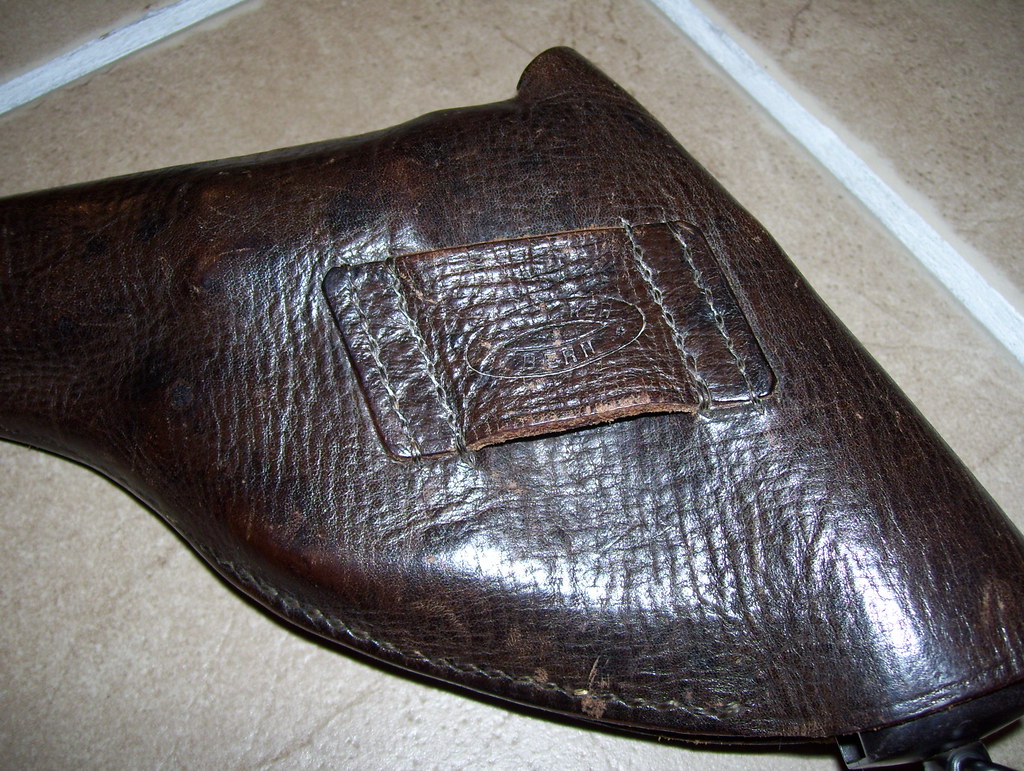

The holster is NICE... marked something like "A.Waliner" (??) and "Bern". From my research it is a very rare cyclists variant. It is either "mismatched" to my gun, or my gun was actually issued with it.

Can you make out the manufacturer name? Yes, BERN is easy to spot, but what is above it?
Too much flash, can you provide a better pic to help ID the manufacturer?
"A. WELTNER" or "A. WEITNER" is my final guess. I spent about 1/2 hour analyzing the holster under different lights and angles. :)
It is my understanding that all M1882 holsters, as with other Swiss small arms of the period, were made locally by Swiss saddle makers under contract with the Bern Factory. So Mr. Weltner was likely a local saddle maker.
There are no military acceptance stamps or year (that I can find), so it's hard to tell whether it's a civilian variant or military issue, but it's certainly original to this revolver, as this revolver came complete with this holster (and lanyard) from Swiss arsenal storage.
