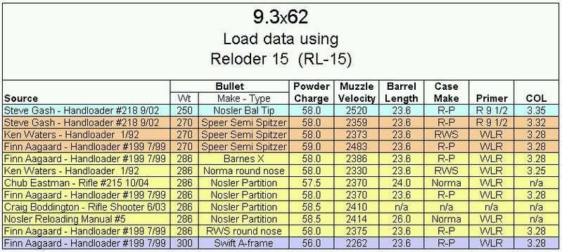

And I forgot to mention that IMR 4350 doesn't compress worth a damn! RL15 is much more acommodating!
Not nice to tease Ted!
The Barnes manual listed 51 grains of RL15 as max. There's a ton of space left in the case and I wonder if this isn't one of Barnes patented manual goofs. I decided to try 58.8 gr as that is Nosler's listed max with a 286 Partition. My logic to this being safe being that in my exerience the Nosler bullet will spike pressure due to the "tough part" in the middle where the belt is. Thus, if that data is safe with a Nosler bullet it should pose no problems with the Barnes. Undertake this sort of experiment at your own peril understanding that it is not a practice endorsed by any company.
I also learned today that my rifle has a rather generous chamber as well. Time to locate a neck sizing die as even by backing the die off to neck size only still squeezes the body some.
I've got some test loads to try tomorrow - 3 @ 52 gr RL15 with partially sized necks, 3 @ 52 gr with full sized necks but not touching the shoulder, 3 @ 52 gr with the bullets set out just short of the lands (3.520" - trying to build pressure) and 3 @ 58.5 gr in FL sized cases (trying to get them all fireformed) seated at 3.282" same as the first two loads. This is the max length that will feed through the magazine - another reason I'm sour on teh Barnes bullet.
I would have bought some Hornadys today but todbartell wouldn't answer the phone at Omineca. I think they have call display!
Oh well...off to the range I go.
