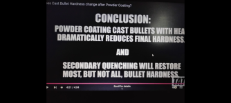

I don’t know for sure, but I water drop all my cast. This is what I got from grok. Looks like if antimony is decently present, it bumps it up a bit. I do it because I tried dropping onto cloth or something and sometimes a base deforms and I like casting as fast as it makes good bullets.
