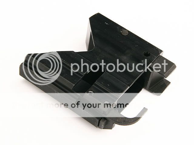

Check out the difference in the feed ramp of the two blocks. The first one is the RRA / C Products style ramp

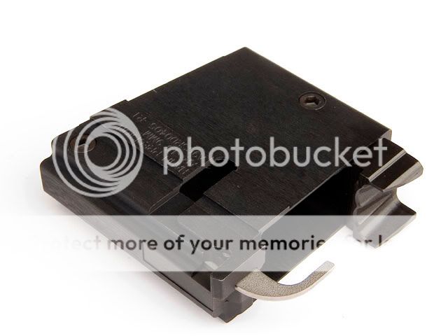

The is a Hahn block. Notice the feed ramps. The mechanism that holds it in place is also better
