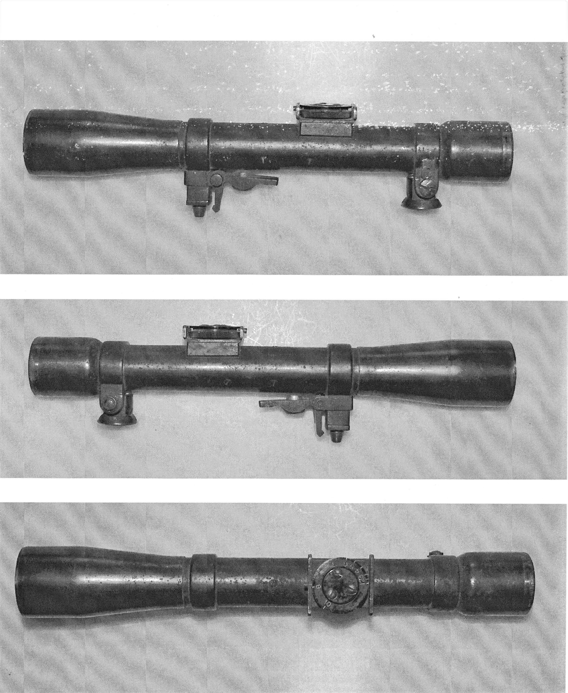

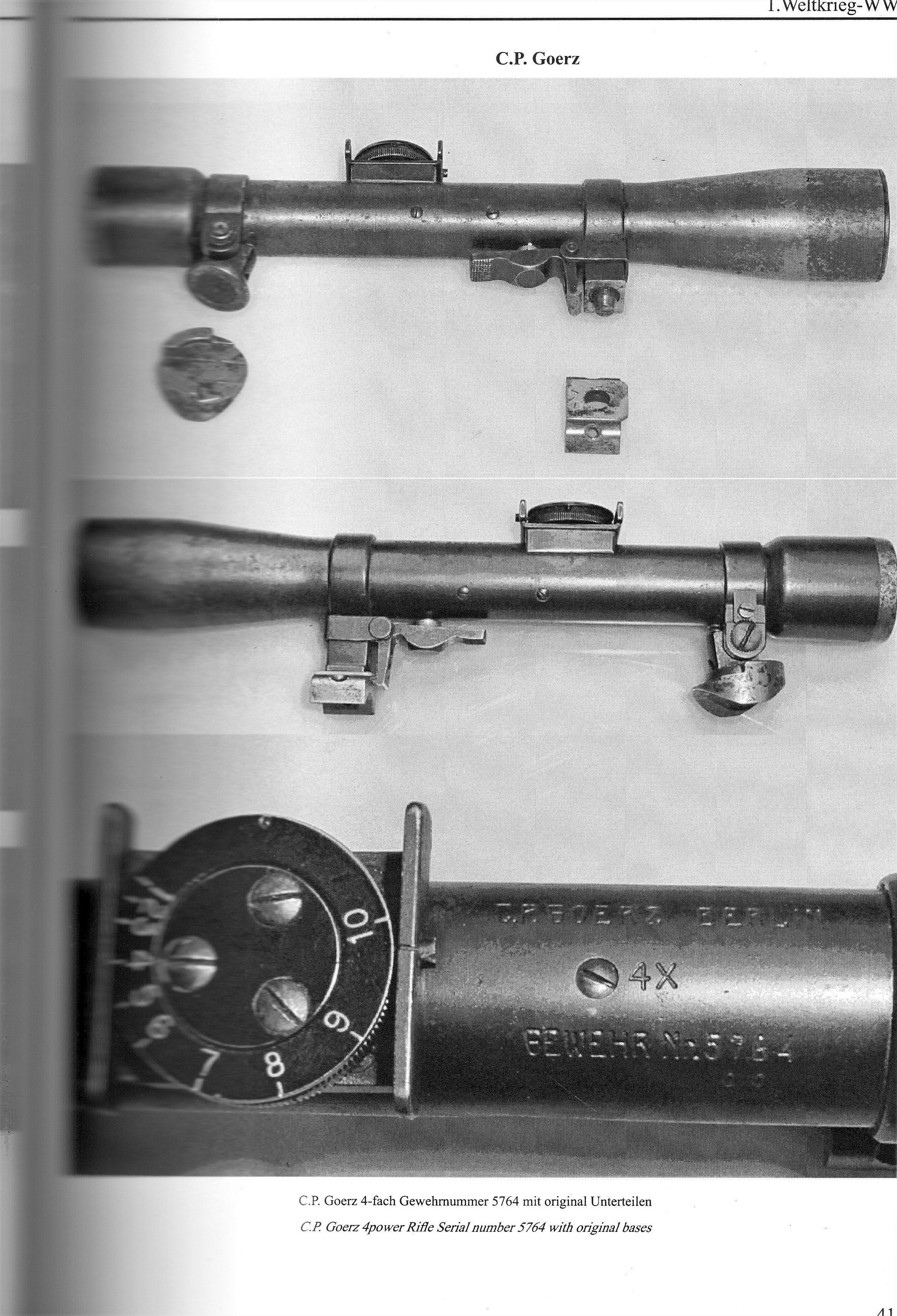

When relatively reliable scopes became available, they weren't "reliable enough" or usable under low light conditions, so they almost all were set up in Detachable Mount systems. Some of them beautifully crafted and mostly very serviceable and would hold a close to zero position when returned to their bases.
