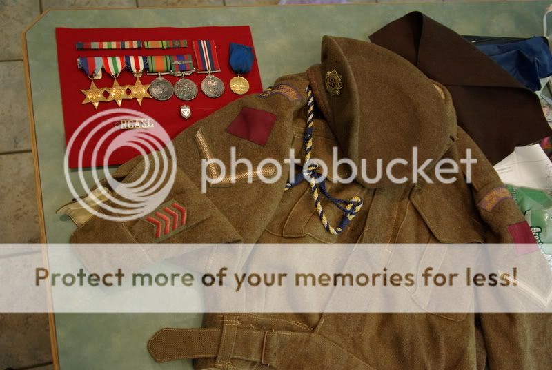

Here are a few pics.
Is this the way the RCASC goes on? There are no holes like the beret has.

the RCASC brass titles were intended to be worn on the prewar Service Dress jacket, the cloth of the epaulettes would be pierced for the purpose. They were not supposed to be worn on the battledress blouse, but such things did happen sometimes. The red chevrons indicate overseas service, as I recall. Canadian (and Australian) battledress was of a better quality than British stuff and sought out by the discerning.
Noel,medals were never sewn directly on the uniform,but were mounted on a pin device instead. If you are going to have all 6 of the medals re-mounted,whoever does the job will fabricate this medal suspender/hanger for you. You could probably use the existing mounting bar by having the ribbons overlap slightly.I have my own personal service medals done this way in the court mount style which looks very attractive(in this style each medal is suspended on it's ribbon with a length of the same ribbon mounted behind the medal). Don't know where you live,but an inquiry at your local Legion should put you in touch with someone who re-mounts medals and who will have all the materials for this,incl new ribbons.BTW,the rectangular maroon color patch on the Battledress sleeve indicates that your grandfather served with the RCASC in the 5th Canadian Armoured Division,nicknamed "The Mighty Maroon Machine". The single chevron indicates his rank as a Lance-Corporal.The inverted red chevrons indicate overseas service-I believe 1 chevron per year of service outside of Canada.The small pin with the 3 maple leaves is a lapel pin given to all discharged veterans for civilian wear.

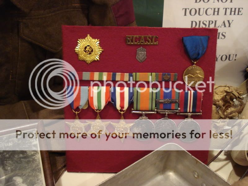

Ended up just making a small display board usingthe maroon felt instead of punching holes in the already fragile battle dress.

I would mount the medals in a frame along with the other bits and only have the ribbons on the tunic.

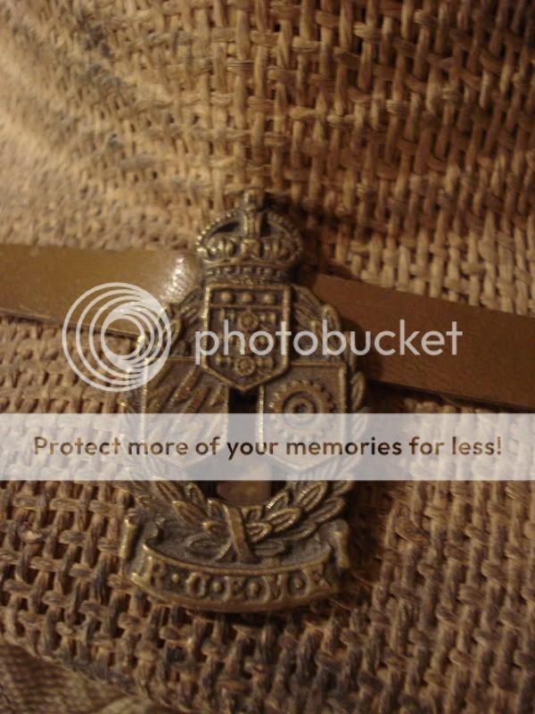

Purple, John Sukey's mention of the cap badge got me to thinking. My Gramma's baby brother was in England as a Mechanic. I bet I got it all mixed up and that badge is actually his from the RCEME(sp). Gramma gave me his mesh hat he used there. It looks like a safari hat for Africa. There is a leather band going over the brim of the front where I have the badge clipped on.

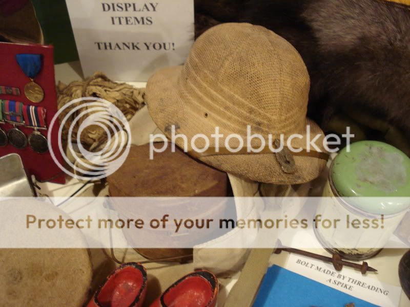

Here are the pics from the display. All the items are either from My Grampa's stuff or my Gramma's brother. As suspected the hat badge was indeed an RCEME. The display was a great sucess.
