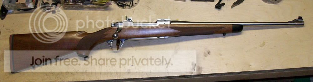

What height rings do you use and what is the objective, I'm probably going to put a 2-7x32 on mine but it seems like it may be a tight fit with lower rings and the rear sight
My rings are medium height, the scope is a 1.5 X 5 Leupold with a straight tube. I would like a lower ring,but I'm not certain if the bolt handle would still clear the rear of the scope when opened..... as it is I can live with it.
Anytime my 66 yr. old eyes can break the inch @ 100 yds. with a 5X scope I more than happy... ;)
here you go moose masher, its on the bottom with the 9.3x62 medium above it for comparison purposes.
