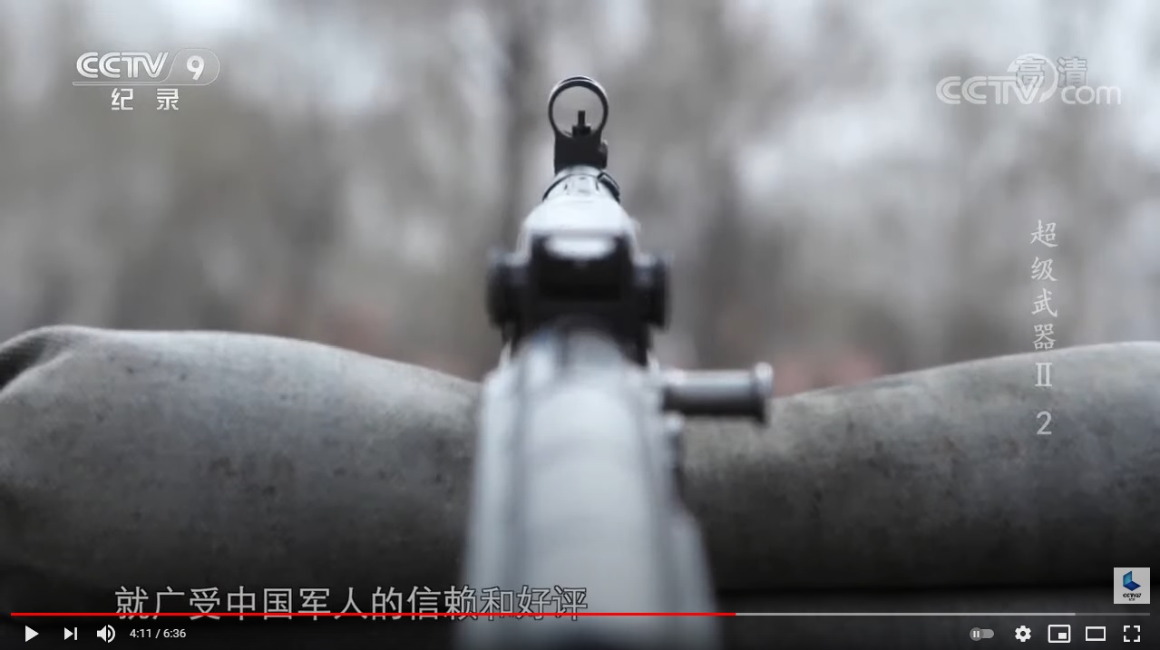

There are actual Chinese military type 81s that are visibly bent. You can see it at 4:10 of this video:

yup, from your pic it looks bent to me too but i didnt get to the 4 min mark cos this is a propaganda vid plus i cant believe they were shooting the casings off the bottle while their left hands are holding the mag.
Its a neat video, but at the same time i call BS on the accuracy demo. There definitely seems to be a lot of delusional pride regarding equipment when it come to the Chinese military. Ive read some pretty outrageous claims online from numerous ex PLA soldiers. Guess they could argue that Western culture has the same characteristic with its military technology as well sometimes...
