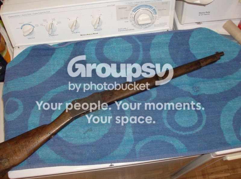

Well here's something which recently came to my home.
I believe it's a MkII Carbine? The barrel measures a bit more than 21 inches.

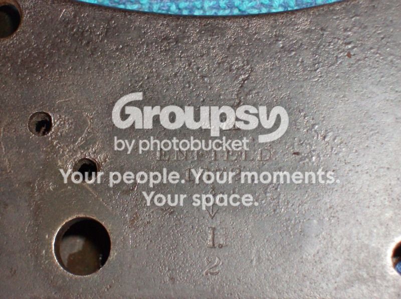

Some holes seems to have been unfortunately drilled on the right side of the receiver, near the cocking indicator hole; no idea why.

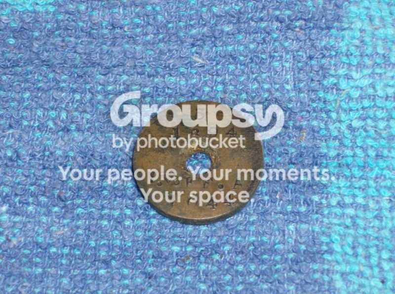

A unit disk was found on the un-salvageable buttstock:

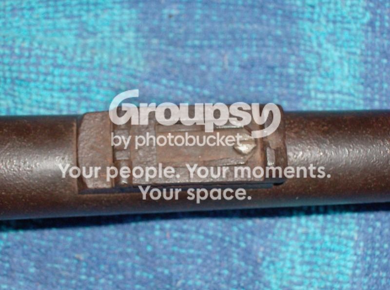

Also, the rear sight seems to be missing it's elevation slide. What to do with this one?

Nice find. What you have is a Mk.II Artillery Carbine converted circa 1891 from a VERY early Mk.I rifle that had been upgraded to a Mk.II. The conversion comprised of cutting the barrel back to 21.3 inches, reducing the muzzle diameter for a P1860 sword bayonet, shortening the fore stock, moving the bands back and remounting the nosecap. The rifle sight was removed, its mounting holes filled and a shorter carbine sight fitted.
As these were made from obscolete arms, they were downgraded to 2nd class, and issued to Volunteer Artillery units and Colonial forces.
The V in the data on the butt disk is for a volunteer unit.

The holes in the receiver are possibly for some flavour of peep sight, not sure which one by the hole pattern but is similar to an old Lyman sight I once took off a gun. But their location seems a wee bit low and a bit too close to the cocking indicator, they appear to be right at the edge of it. Perhaps they were put there to run a couple of screws in so that their heads would keep the cocking lever from moving, kinda like deactivation to prevent kids taking it off the wall and trying to shoot it. The holes can be blanked with screw shanks, peened and filed flush. Not invisible, but certainly better for cosmetics.
The sight slider will be a challenge to find, keep eyes peeled on Epay and Gunbroker, they do pop up in job lots of junk. In the meantime, a MLE slider would fit and work and would not look out of place. There would be enough metal in it and could be filed to the carbine dimensions, the only giveaway clue would be the checkered ends being reshaped.

Very nice. Reminds me of a Mk.II Artillery Carbine I once had. Keep that unit marked disk, read up on it if possible. Not common! I had one in mine, dated to the 3rd Lanarkshire Volunteer Regiment, 1898.
