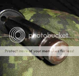

A CGN member tasked me with some TLC on a Martini of his. Believed to be a military trainer at first, upon closer inspection I started thinking that it could be something slightly different. It was prepared "For the NRA by W.W. Greener".

Greener never made them, they just converted them. The rifle is a military rifle and they were made up in .22 for the miniature rifle association in the UK. Most are well beat up as they were used as club rifles. They were a cheap rifle for the clubs to use for applicants before they got their own firearms certificate that allowed them to buy firearms. Most got sold off about 30 years ago via UK auction houses.
Martini Enfield converted
Around the turn of the 20th century, the British Empire stretched around the globe. She had one of the top military establishments and encouraged marksmanship back on home soil and in the provinces. It was thought wise to teach its citizens how to shoot as this was the pool from which its future servicemen would be drawn.
Rifle clubs were very popular and actually supported and encouraged by the government. Many well equipped private and public schools had a target range. My Grammar school had a 25 yard range built right in a basement running under the main corridor. Drill halls had them as did many municipal buildings.
To meet the demand for small bore rifles, companies such as Greener converted military service rifles, in this case a 303 Mk.II Martini Enfield, to small bore. There were a couple of different calibers, but .22 rim fire was probably the most popular.
The rear peep sight is an accessory item, not military.
So you have an ex military rifle converted to a range or target rifle.
Usually great shooters with that stiff barrel fitted with a .22 liner.
Nice thing is you can practice with the Martini, fire 100 rounds and still have a shoulder. Cheap to shoot too.
These rifles are often overlooked, they are fast becoming a collectible as witnessed by their steadily rising price tag.
I have a Martini cavalry carbine that is converted to 22 by an unknown, it is an absolute tack driver right out to 100 yards, but limited by its service sights. Hence the need for peep sights.
Nice gun. Clean her gently, fix her up, but try to leave the patina intact. A gun this old is allowed to look this old.
P.S.
'SX' is a military mark denoting that the rifle was at one time retrofitted and upgraded during its service with a Strengthened eXtractor
