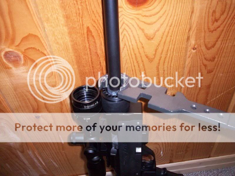

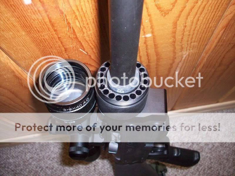

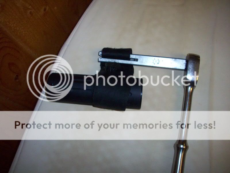

Here is what I used to remove and replace the free float tube on the 597 VTR. The hardest part was getting the barrel nut off with that stupid heater hose wedged in there against the barrel. As has been mentioned in this thread the ff tube and the barrel nut are not hard to take off if you have the right tools.
Removing free float tube with strap wrench
Removing barrel nut with AR tool
Note heater hose around base of barrel

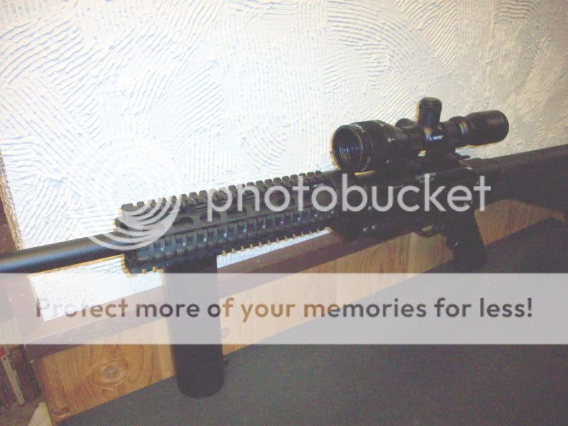

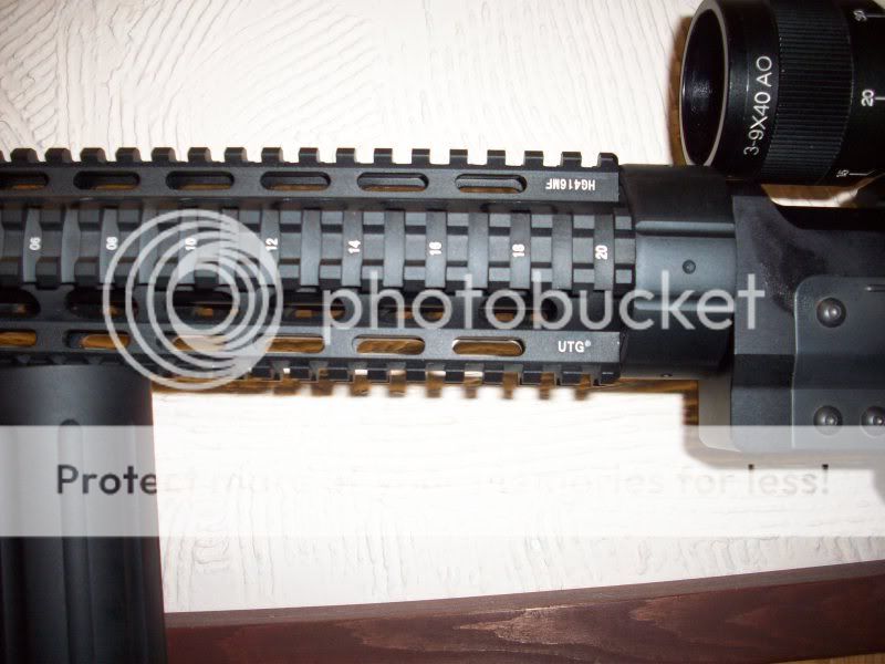

Reverse process to install new ff tube, By the way, I got this one from Questar for a quarter of the price of the one you are looking at. Will all that more money make your gun shoot better- I don't know.
Question for Satain or Anfoman 76: Do you have to replace the heater hose on the new ff tube because if you do it's going to take forever to get that sucker back down to the base of the barrel. Anyone know if you have to?
And yes, I will be putting a riser on the scope base. It does actually clear it but not by much. This was more to show what needed to be done to remove/replace the ff tube.
