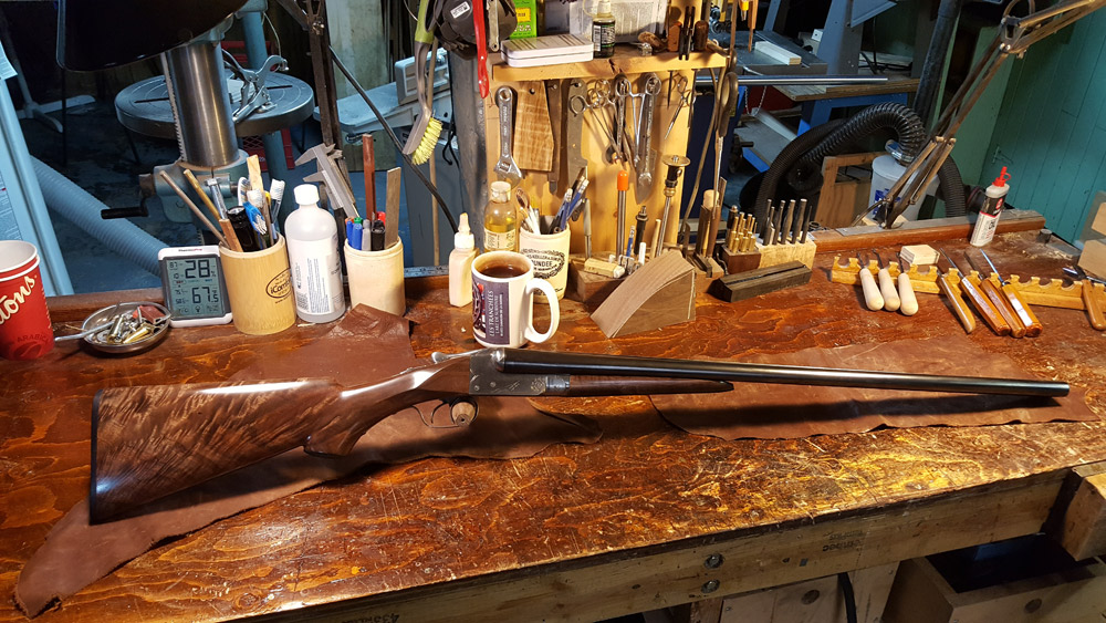

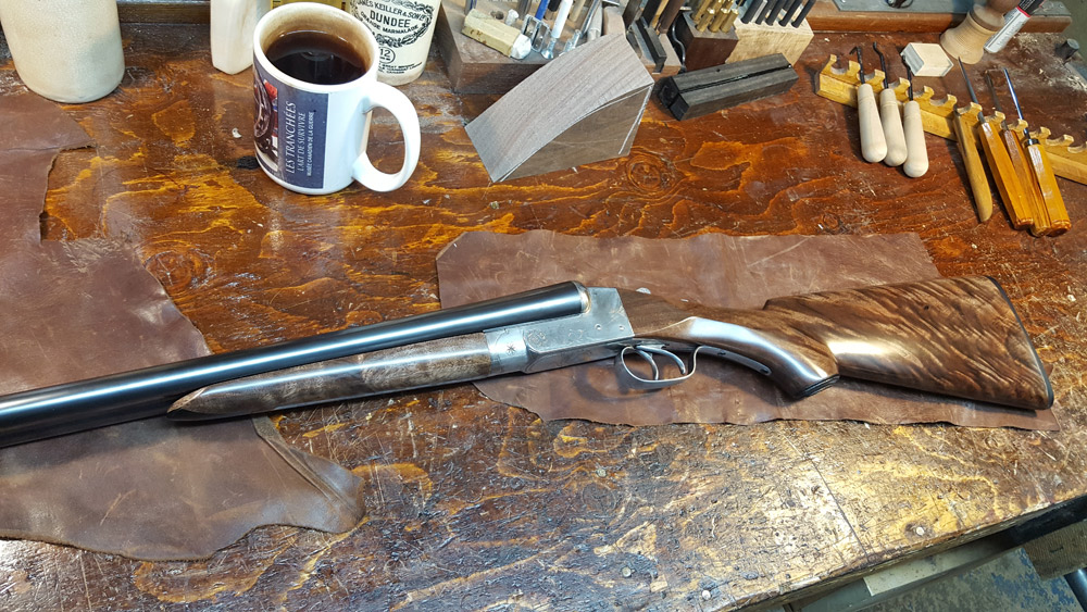

Very, very nice. To me, this is the perfect look for a finish. (not to mention you're working with some nice wood)
You mentioned that you use a mixture of Pure Tung Oil & mineral spirits and then wax at the end. Would you mind sharing your steps and process? i.e number of coats, percent pure tung oil & percent mineral spirits, drying time between coats, any wet sanding between coats or just at the end prior to waxing, etc.
I just started a stock with Pure Tung Oil (Lee Valley) so I am very curious because I am after exactly the look in your pictures. So far I have; 1) sanded the stock to #400 2) applied one coat of a 50/50 Tung oil/mineral spirits mix, let sit for 30 minutes and wiped off 3) wiped off any seeking during the first day or two until there was no more. It as been drying for one week now and is very smooth to the touch.
My current plan is to use Renaissance wax at the end. (my understanding is that Lee Valley Conservators wax is the same)
Any guidance would be greatly appreciated.
That came from 3 book matched slabs from walnut bole - they started out at about 4' x 3' (ish) chaotic grain but if you can find the right spots where it flows it's really (REALLY) nice.
