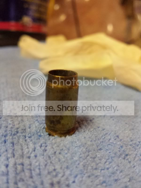

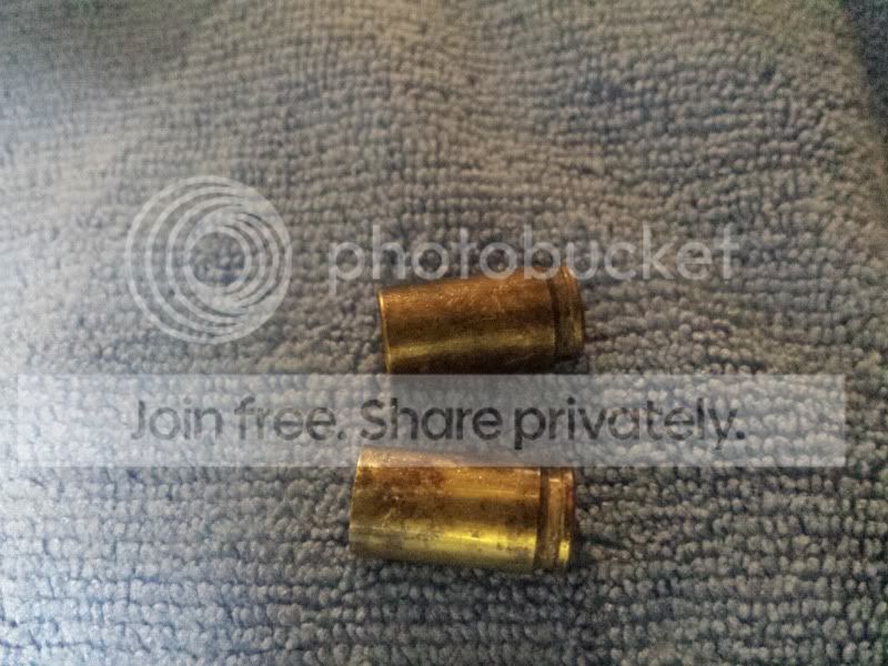

These are outdoor range pickups.
First question, would you reload these?

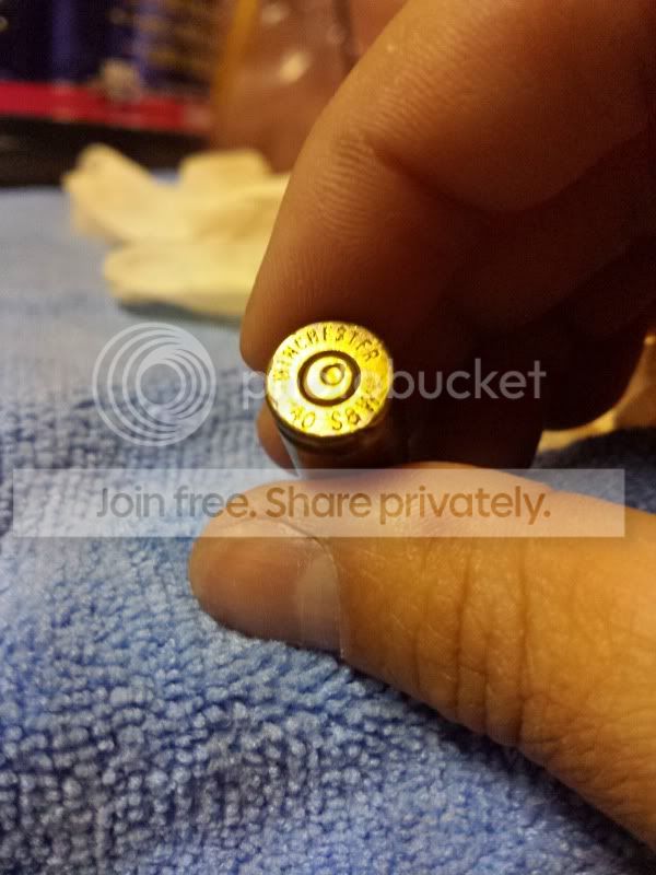

Second question, I found a few of these 40 S&W casings. Just wondering why (excuse me for the proper lingo) the opening is like a 9mm?
They are pretty tarnished, I'd throw them in the tumbler and see how they clean up and then go from there.
The other case is 357 SIG, it's made from a .40 case.
as stated above, clean them up and check for cracks/etc .
in your first picture, the case on top looks like the rim is pretty much gone, i would likely toss that one unless it's just a funny angle.
and the 40's cases necked to 9mm are 40cals that someone has converted to 357sig.
Yep. Those will clean up in a tumbler. Might take a while though. Visually inspect 'em for cracks first. However, range brass can be bad and you have no idea what has been done to it or how it was loaded.
"...the opening is..." The case mouth. And neck in this case.
