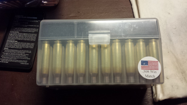

Decided to grab 100 pieces to see if they are all hype or quality reasonably priced match grade brass.

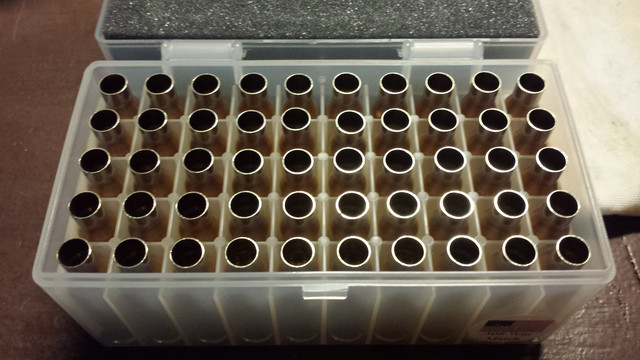

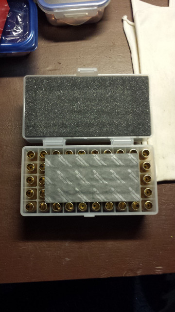

Nice box, anti-tarnish paper and foam in top to keep everything from bouncing around bending necks...that works as the brass is clean and necks are round.

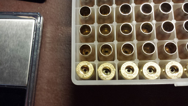

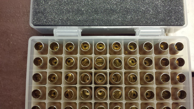

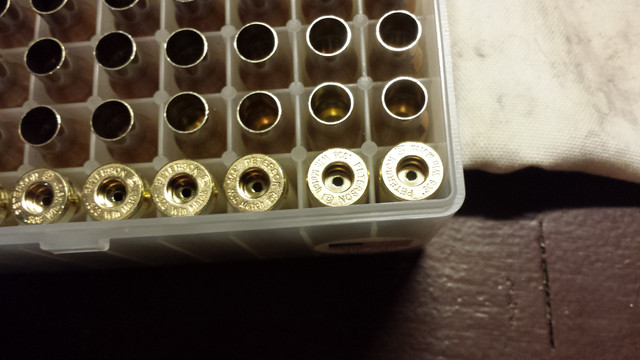

Visible annealing left on cases. Cases are trimmed but not inside/outside chamfered so the burr will need to be removed and that will be required prior to loading. Flash holes are deburred and chamfered inside the case, and inside the primer pocket which is a bit odd, also you can see some chatter marks in the primer pocket flash holes which I don't think is good. The inside deburr and chamfer of the flash holes is inconsistent in depth, some barely touched, some have way too much chamfer for my liking.
