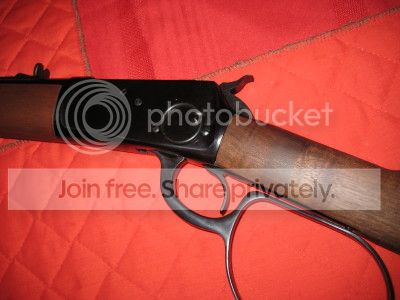

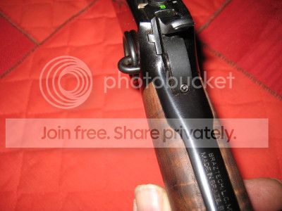

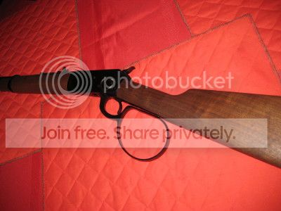

Fit the stock to-day. Pretty close just the way it came, just a little work and sanding to fit contours. Colour match is not right on but it's a working gun not a show piece. Only took about hour and half. Pic is a dark, I'll try for a daylight one for better colour. Happy Happy Happy!!!!!!!!!!!
