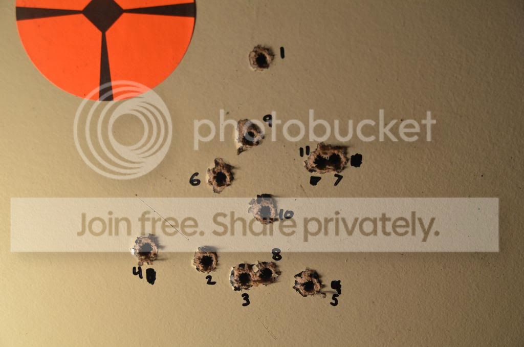

so I was at the range and tried to work up a load for my 300wsm with 150gr TTSX and H43450 powder. Bullet is seated as long as my finnlight magazine will allow.
Results of the ladder... this was at 200 yrds unfortunately. I could not make it too my long range area due to high snow level still.
#1 63.5gr no reading
#2 64gr 2915 fps
#3 64.5gr 2907 fps
#4 65gr 2992 fps
#5 65.5gr 2994 fps
#6 66gr 3077 fps
#7 66.5gr 3083 fps
#8 67gr 3141 fps
#9 67.5gr 3148 fps
#10 68gr 3220 fps
#11 68.5gr 3382 fps

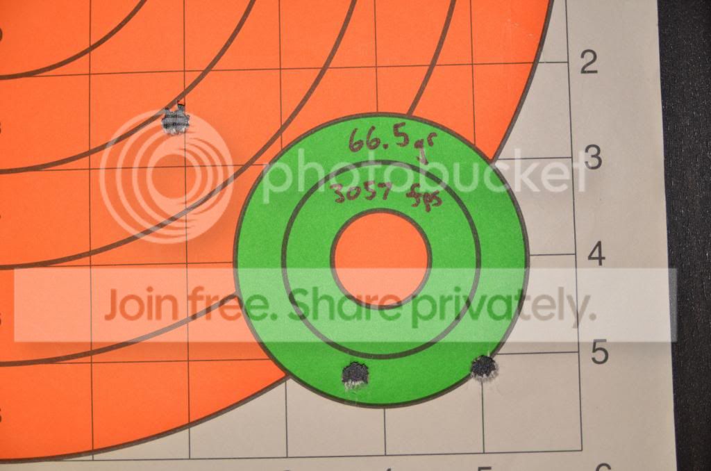

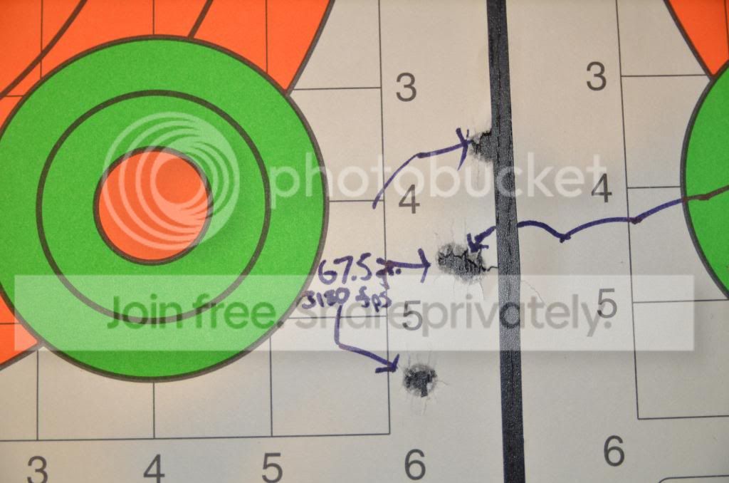

I was totally confused with the ladder because it looked to me at if 2, 3, 4, and 5 were good spreads as well as 9,10, 11.

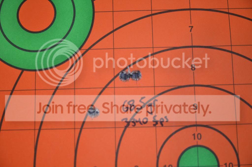

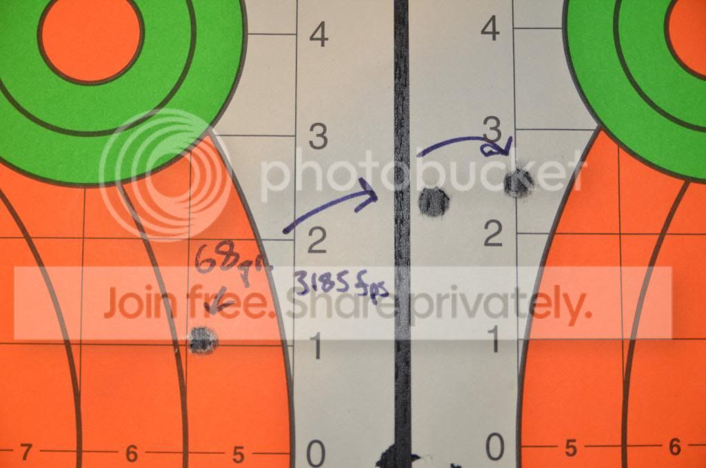

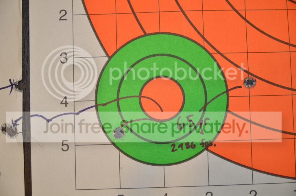

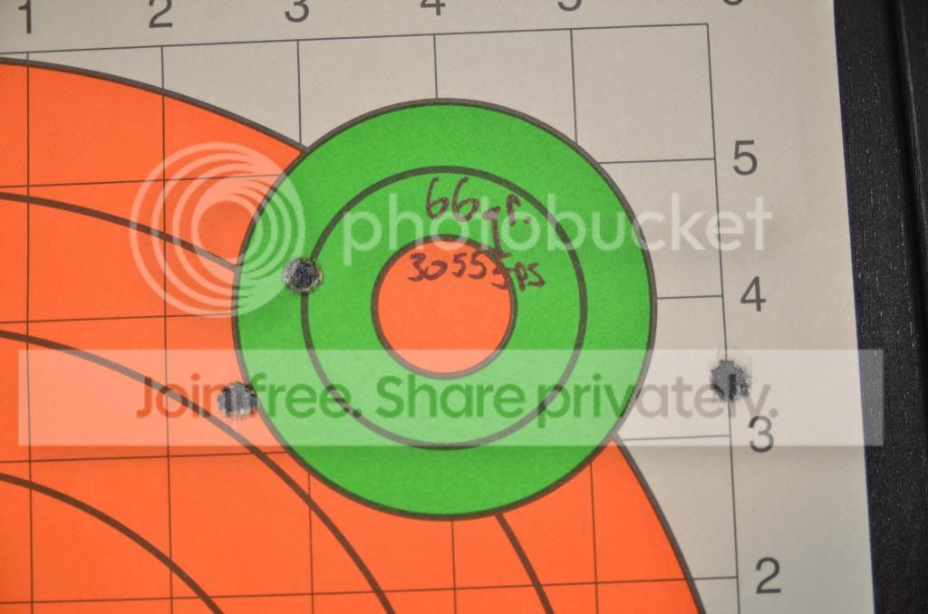

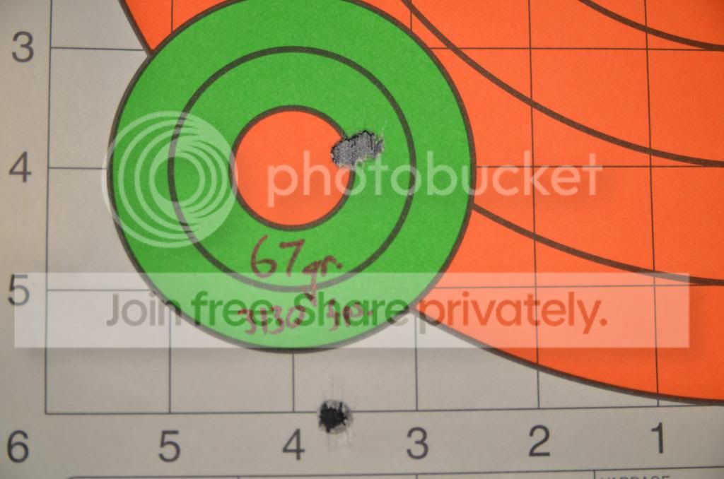

Not wanting to waste the day I sent off three rounds of each at 200 YRDS until I ran out of light. Here are the results with the averaged velocity.
200yrd results:
What would you guys get from these results? I was very hesitant to start the group shots with the 63.5gr and 64gr loads as they gave me 30.06 velocity and well, I am shooting a 300wsm not a 30.06...
What Next?
