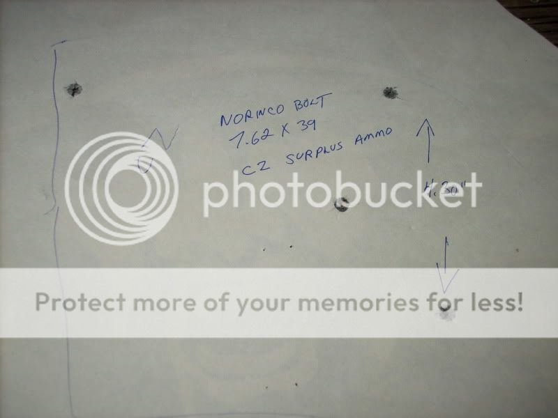

The good news is that after bedding both rifles now shoot much, much better. The 7.62 probably shoots as well as the cheap surplus ammo permits, but I did not shoot handloads to prove the ammo is a factor. The CZ surplus (blue box) shot 4.3” at 300 yards, or 1.5 MOA. Perfectly acceptable and useful. I would not hesitate to use this rifle on a deer hunt.
I also shot some Wolf (Russian) 123 gr HP ammo. It shot 19” higher at 300 yards (hotter load?) and a much bigger group – 8.0”. I would say the quality of this Russian ammo is poor. Some of the rounds sounded louder than others. It would probably be ok for plinking at 100 or less yards.

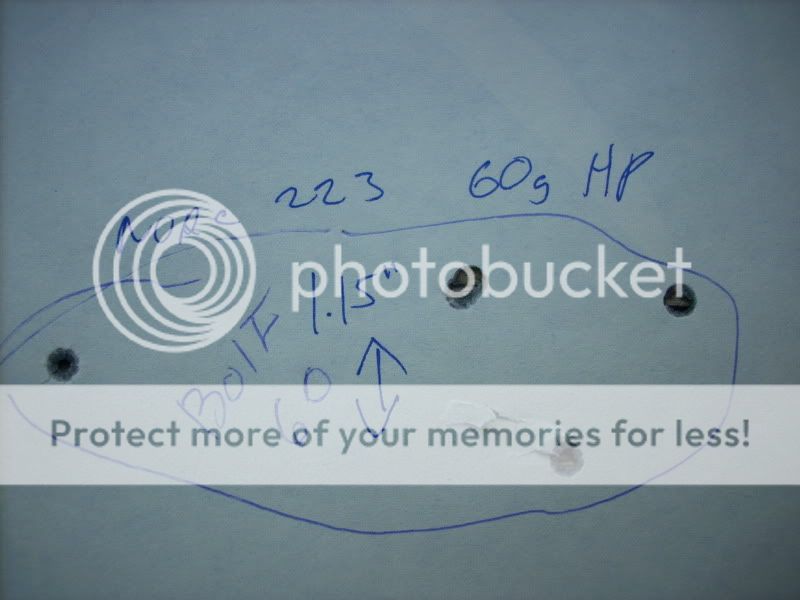

The 223 shot sub one minute groups, which I would not have thought possible. I loaded 5 different bullets, making a guess at an appropriate charge of H335 for each. That is, there was no load development or load survey involved. I used H335 because it would throw accurately. I did not want to weigh charges. I loaded the military 55 FMJ because I have a few thousand of those and the 55 V-Max, because it has been an accurate bullet. I loaded the 60 gr Sierra flat base HP because it is the heaviest bullet my 1:14 222 will shoot. The Norc has a slow twist (I am guessing 1:12) so the flat-based 60HP is probably as heavy a bullet I can shoot, although the 62 gr IVI shoots ok, too. I also loaded some 68 gr match bullets, fully expecting them not to stabilize. They didn’t.
Results 300 yards H335
26gr 55 V-Max 4.8”
26gr 55FMJ 6.8”
25.5gr 60 HP 1.15”
25 gr 68 Mtch 5 feet
55 FMJ CQB load 24gr 3031 (mild load for close quarter match) 6.3”
The 60 gr HP looked outstanding.
Any group under a half minute in a $239 sporter is remarkable. This was the bullet that Sierra recommended to me as the deer bullet for my 222. (I have a O/U combination gun in 222/12ga.) If I ever wanted to use the Norico 223 on a deer, this would be the bullet. The fact that it is accurate also makes it the general purpose bullet for this rifle. It out-performed all the other bullets. I have no reason to think this bullet would work in other Norc 223’s. It just proves the value of trying different loads and bullets until you find something that works. In this case, I got lucky on my first attempt. Just to make sure it was not a fluke group, I shot a 10 shot group. 10 shots in 4.25” is 1.4 minutes. Plenty good for any plinker, sporter or hunting rifle.
