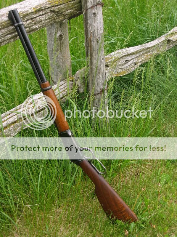

The levergun: A Winchester model 94, 30-30, made in 1954. It is the only gun I have a name for .... Old Savage. It is a good name, and fitting for the Canadian wilderness, where it will be my camp gun when canoeing and camping with my wife and kids in remote areas. I'm also hoping to bag a deer with it come fall. Here's a photo I took after getting back from the range ...
