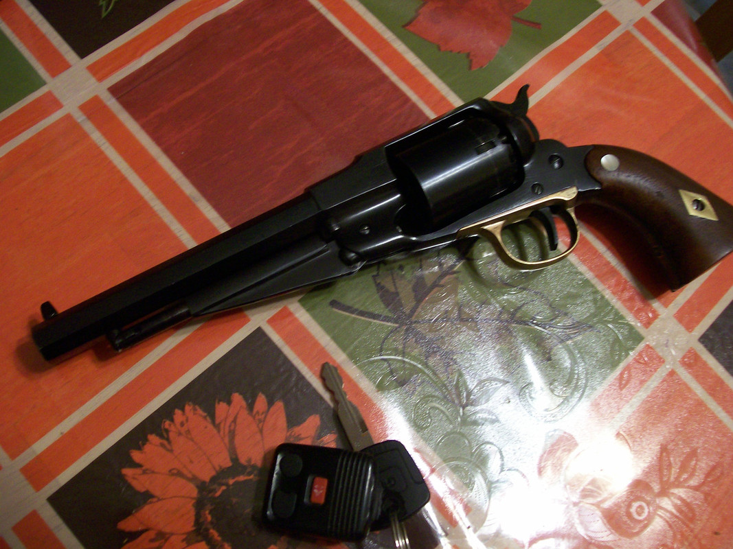

I have a Uberti 1858 36cal revolver I bought off CGN

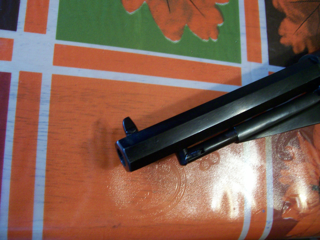

Took it home and made the front sight 80 thousands higher.
Took it back to the range a while later, and much better results. It shot 4 inches Low. So I got out my file and went to work. I took about 20 thou off to hit center at 25 yards.
It was still hitting right,...so I hit the right side face of the crown with a punch " gently" and it Worked. It moved the ball left. Now I was dead On. This technique was used back in the day to sight in black powder guns with little or no real sights.

the 36 cal 1858
Used silver solder to make the sight taller

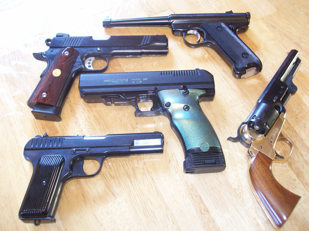

you know whats really sad.......this cap N ball has better accuracy than my Norinco 1911 45 LOL

the 36 cal 1858
