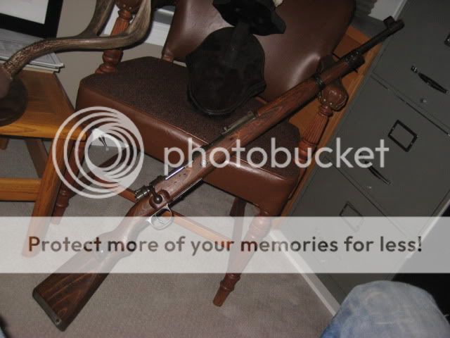

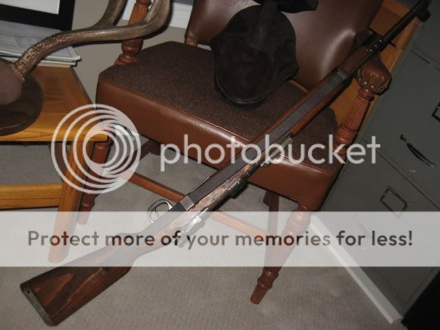

its the orig stock (rc)i thought it was neat that the barrel was made in 44 also its bore was mint and i mean mint.it actualy outshot my unissued pourt41.i guess it likes that stock.once in awhile you get one like that

Yours looks good except has a replacement flat butt plate stock with some serious refinishing. The phosphate finish was common in 44-45, i have the same rifle but with the Kreigsmodell stock. There wasnt alot of byf 45's made if i remember correctly.
That second byf45 is really nice.
