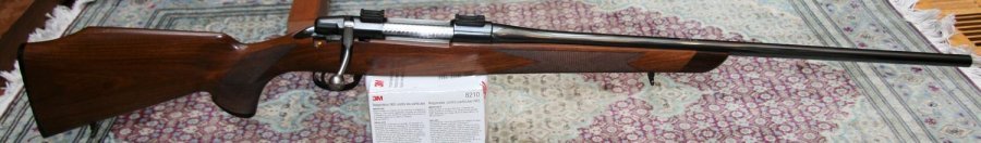

What you thinking on buildingHas anyone re-barreled a 1900 action, from either a Husqvarna, Carl Gustaf, Viking or Antonio Zoli? Wanting to know results, good or bad. Would it be worth the cause? Thanks!
Brilliant response. I’ll forward it to Ralph Martini. Maybe he can have it transcribed onto a plaque as a not-so-subtle reminder of his, and his generation of gunsmiths’ failings.Probably gonna have to count out all the befuddled boomer smiths who can’t or won’t cut metric threads
What you thinking on building![]()
You know, Jim I recently purchased a Viking 1900 Deluxe chambered in the 6.5x55 Swede and was beyond impressed with the quality of workmanship. No, I'm not going to rebarrel that rifle however, searching for another in the 30-06, which I located, just have to seal-a-deal with the vendor.What you thinking on building![]()
