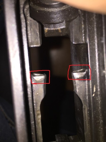

It wasn't NEA, it was Rausch tactical. The nitrocarburizing wasn't done properly and the receivers were softened. The points where the locking block engaged deformed causing excess headspace, then, eventually it stopped the bolts fore and aft travel. The finish on the barrel lived up to the promise of corrosion resistance, but that's all. I have a like new rifle with 600 rds down the pipe that is cooked.
The guy who did the work never had the decency to return my attempts to contact him.
Thanks for nothing Sean Rausch.

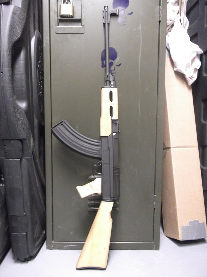

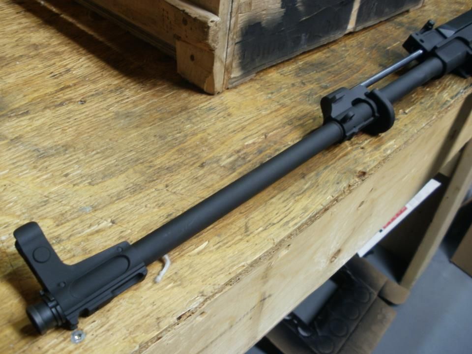

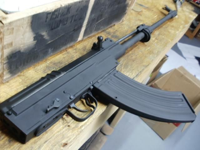

I sand blasted my CZ858 years ago.
Then did black cerakoat on the whole thing and cooked her in the over to harden it.
It shot many many rounds after that with zero issues whatsoever.
The sand just dusts off the #### paint finish.
The heat required to harden it is very low, lower than gun probably even gets during heavy firing.
Here is a couple pics of it redone:
Not hard to do at all. The CZ is about as simple of a forearm to fully disassemble as they come to do the work.
Just plug the inner receiver/barrel up very well with clay and tape when you do the light sand blasting obviously.
It was also very durable actually, surprisingly so. Took the heat of many thousands of rounds after and a lot of rough handling in the woods etc
I sold her shortly before the ban. It's one of the ones I regret still.
