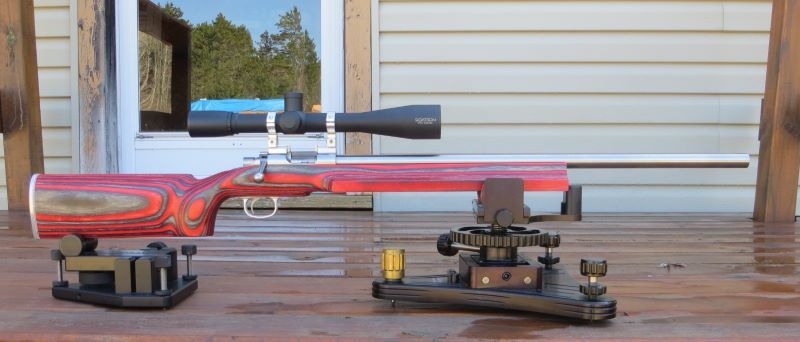

There are two revisions, based on some online reviews I ordered the older rev1 with narrow contact points. Turned out I would be just fine with rev2 wider "V" as well, I did a 3d print (visible in the picture).
(the sticker - 60mm is from my one-piece-rest, the height between front arca to rear sled "V" contact points. With these 3d printed parts I got very close to that number, but my front tripod gimbal has an adjustable height clamp anyway)

I got sick and tired of repacking the sand in the soft rear bags, 20-50 shots and the grit packs hard. I wanted to have adjustment at rear (below my cheek) instead of front and this how I came up with idea front tripod and rear adjustable rest.
The windage/elevation travel covers the N50 5x5 card fully, for 22LR cards plenty of room left.
