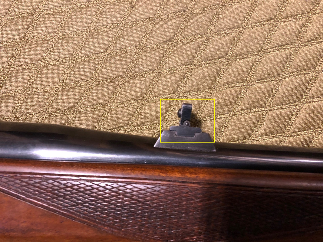

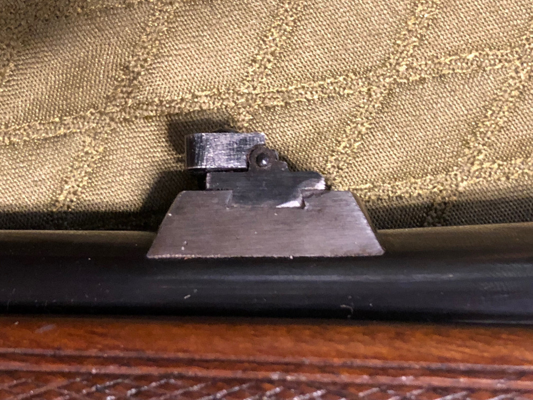

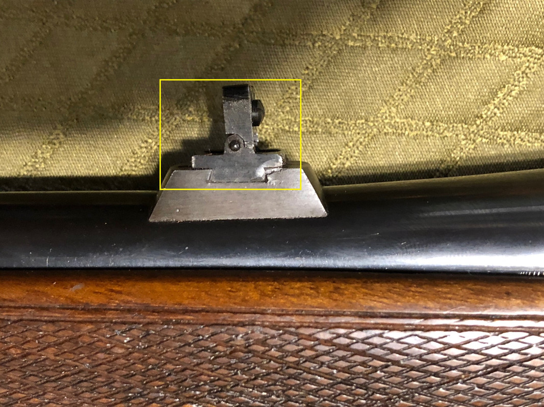

In order to test for accuracy my Zastava bolt rifle ( Zavodi Crvena Zastava), I need to remove a section of the rear sight, so my 50mm 24x scope will fit. (Even with the extra high rings on , it is hitting the sight....)
I suppose I have to bang the sight sideways with a soft punch, so it will slide off the dovetail ? Can it come off from both ways ? anything I should know before attempting ?

I know on some rifles it goes out a certain way. Cant really tell from the picture. If it isnt going one way try the other before you really whack it
As smokeeter suggests, out towards the right side when looking down on the sight with the muzzle facing away from you.
The main thing is to support the barrel and even better the block the sight is on if possible so that the force of the impact is concentrated on the sight. This is even more important if it's a tight fit. Might be easier to remove the stock and use a vice or some creative blocks and an extra set of hands to hold things while you hammer it with a punch. A small square punch of hardwood will usually work if you can't find or don't have a brass faced punch.
X2 what Can-down wrote!! Without proper support of the front sight ramp, it simply popped off when I tapped with brass punch on the front sight insert - was on my Zastava M70. Thought it would be soldered in place - not so - a shallow dovetail with a "top-hat" shaped insert and some stuff like loctite. Don't be assuming what is holding your rear sight block in place!
Well, a couple of screw heads are visible.
A sight pusher is best. If a drift must be used, remove the barreled action, and hold the barrel in a padded vise with the sight base supported. Knocking the base off the barrel is not impossible.
A brass drift may leave brass on the sight. Use bore cleaner to get rid of it.
Yes - pulled mine out of storage - I eventually did remove the rear sight base - two screws - small 3.0 or 3.5 mm - could only find allen head grub screws to fill the holes. And some more of that "loctite" type stuff was also under there. But, I agree - a sight pusher is the correct tool to use!
