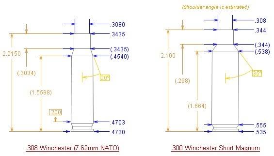

I've got an extra Savage 10FCP McMillan in 308 win and I'd like something with a little more punch. I was going to build a 300 Win Mag but then thought I'd see about 300wsm in this rifle. I know about the large/small shank issue but why can't a custom barrel be made to work? As it stands my rifle has a 26" barrel so chould't I just get this rechambered or even a drop in PacNor 30" rechambered? Yes, I know about the bolt head change as well. I've read that you can push a 210 VLD from a 300wsm 28" barrel and that is very interesting! But the 190's would be fine too.

Comparing dimensions on the two cartridges, you should be able to run a reamer into your existing .308 barrel and convert it to 300WSM without too much difficulty. ( I'm not a gunsmith, and I may be just some crazy internet nutjob, so consult an expert !! ;) )
