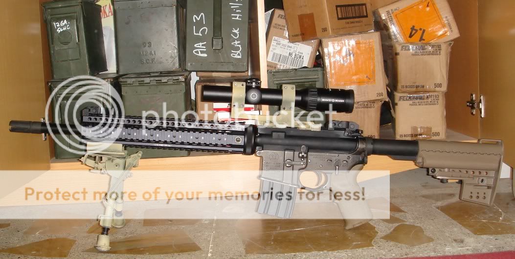

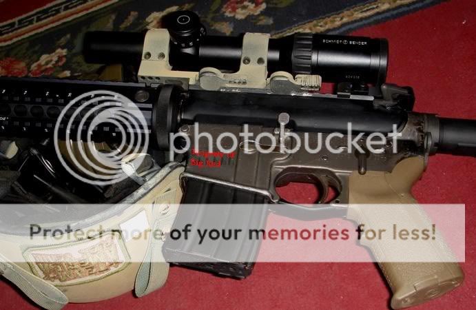

Found this in my mailbox earlier this week.
Harrington & Richardson M16A1 Lower - It's been through a few wars :D
Whiteoak match 16" barrel
vortex flash
pri handle
larue 12.0
vltor gasblock
harris w/larue
short dot w/larue 1.93
vltor clubfoot
magpul grip
magpul trigger guard
troy sights
Lots of C-products mags with magpul gen 2 followers filled with mk262
There's other stuff I can't recall and things not in the picture. I just told them to build the most accurate 16" recce they could and this is what came. Test fire was grouping .5-.75 moa with 77 gr mk 262.

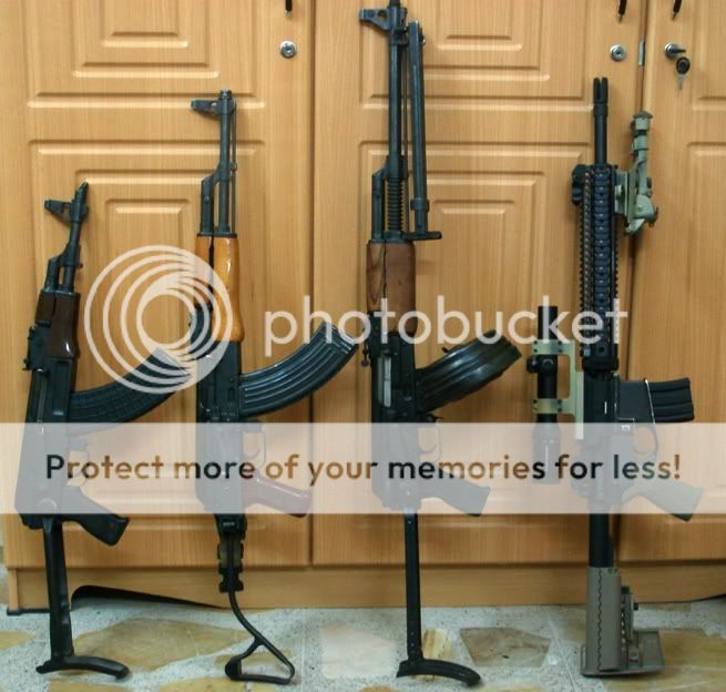

The other rifles in the pics are just what was lying around the room. Shorty Hungarian that was a part of a group that we had an IA armourer build, Side folder from europe (too lazy to check where from), Tabuk Yugo RPK copy w/drum.

Side folders are 10x more solid than underfolders. Underfolders tend to flop around when changing firing positions once they are worn in.
Both the side & underfolders have #### cheekweld. If I was going to use one of them for any length of time I'd guntape a piece of foam to the side of it. Might as well run fixed stock AKs if you're high pro as the folders don't really serve any purpose except trying to hide the weapon during low pro operations.
Thanks. I used to own a bottom folder and I liked it for being a tad longer, but the flipfloppy butt part was irritating. I also shot a 74 folder, and that stock seemed decent.
