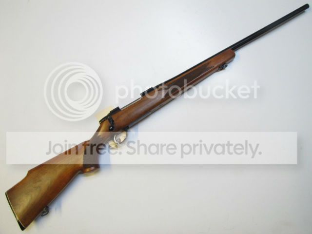

I have just acquired a Sako Aii (L579) in .243 win. Here is a photo of her:
The Sako Aii is a classic from 1979-80 and has a receiver with a tapered dovetail for attachment of the scope. I have never owned a Sako before and of course I want to set up my beauty correctly and I am hoping that, in this regard, some of you with more experience can share your knowledge ...

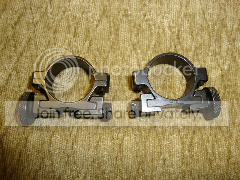

I recently acquired a set of the old-style (pre Optilock) Sako rings that were made specifically for that receiver. They are nice and trim rings and they seem very strong so far.
These old Sako rings are certainly a great deal leaner and less clunky than the Optilock system, and I got them for cheap. It might be a good option.
On the other hand, I've heard that Optilocks are incredibly strong. Their only downside appears to be cost and size.

And, I have been made aware that era-correct integral ringbases made by Sako,
are now available, but only in Low height :
