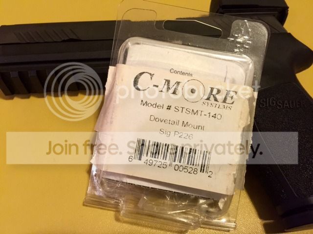

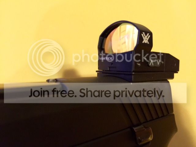

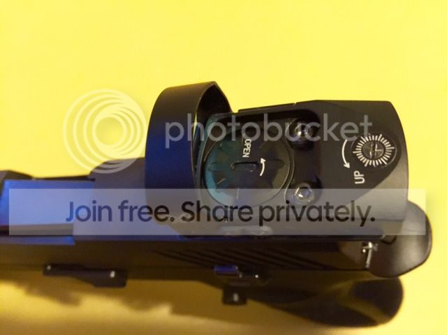

Anyway, for those who might consider this setup, there were some modifications req'd to the C-More mount to accept the Vortex optic. I should have photographed the process but didn't think of it at the time. Plus I wasn't sure how it would go, if it would even work, until I finished it. The 'dovetail adapter' is a very tight fit as stock but a little help with a triangle file and some 200 grit paper relieved enough material that a few taps with the plastic tipped hammer set it in the centre of the rear dovetail. Then the 'slide adapter' sits almost perfectly, matching the contour of the slide, over the dovetail adapter. The metal 'slide adapter plate' that sits on top of that has 2 raised 'bosses' that are there to facilitate the alignment of a STS Red Dot optic, but there is no accommodation for them on the underside of the Vortex optic. So I removed them allowing the Vortex to sit flush on the plate. I then used half of the 3M double sided adhesive strip provided to go between the slide and the 'slide adapter' to go where the 'bosses' had been, helping to secure the Vortex to the 'slide adapter plate'. There are 2 hex head screws that mount the Vortex to the 'dovetail adapter' very securely but the tape just made a little added insurance.

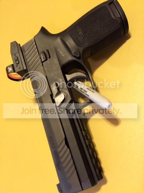

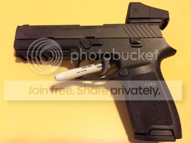

Here are a few pics of the finished product...

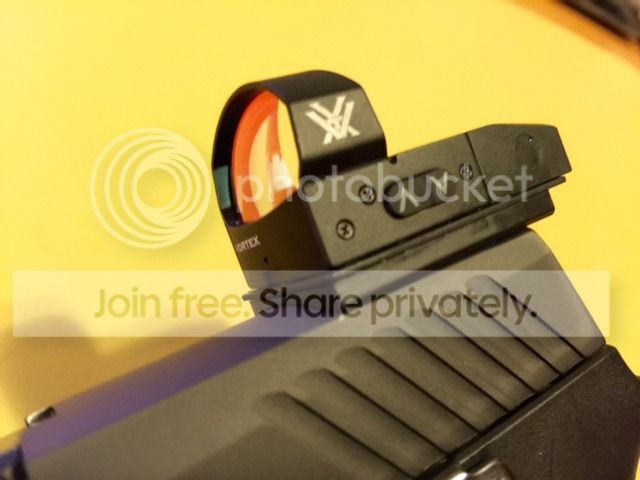

With the protective cover on...
