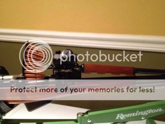

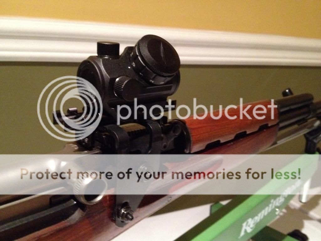

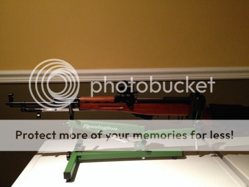

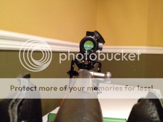

red dot or variable powered sks?
Photo coming, 5 shots per group, every shot finished in one second, what a pleasure.
image_zpsb8fa7a70.jpg.html
Not working?!
I ran into problems with my BC tactical mount and a vortex sparc.
The brass would still bounce off the vortex sparc - I didn't lose zero - but I'm sure if kept it up it would damage the optic.
Is anyone using this set up with compact red dots having any issues with this?
