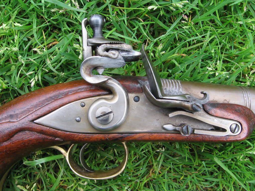

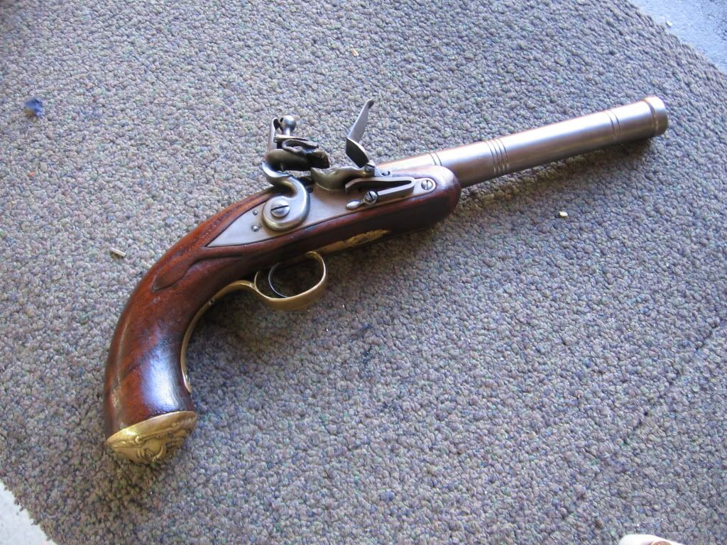

I looked a my Pedersoli Queen Anne .50 cal. flint pistol and there is about a 1/4 inch channel leading to the chamber, this is the gun that prompted this thread...the delay is pronounced.
This is sort of a "pirate pistol" anyway..no sights and smooth bore but it is a hoot to shoot and always gets a few laughs at the range.

Your "Fix" could be as simple as installing a coned vent insert of the "White Lightnin' type for about $4 and half an hour in the shop

Great looking pistol!! Thats the pedersoli Queen Anne.
Dont let the lack of sights discourage you, My bess only has a bayonet lug and shes able to hit a man sized target at 75 yards when I do my part.
Just putting powder in the pan, how is the ignition? If its fast you may just need to open the touchhole a bit, if the pan ignition is slow it could be a old worn frizzen, dixiegunworks can send you a new frizzen.
Im of the thought that lots of prime is the way to go in most situations. 2f goex, give the frizzen a good cleaning with some rubbing alcohol and slap a new flint in her.
I bet you can tweak her into a real firecracker with some doin, pedersoli generally makes really good stuff.
Tlhe degree to which a lock sparks is in part due to the amount of carbon in and the hardness of the surface of the frizzen. For many replica guns, the frizzen is case hardened and when the casing wears through, the gun will more or less stop sparking. At that point you need to recase the frizzen and most people use Kasenite. To use it, you need to heat the frizzen red hot and maintain it that way for at least 3 minutes (by a clock) while covered with Kasenite. The carbon penetrates about .001" per minute hence a shorter time and you will have to recase much sooner. The location that the sparks fall to is based in part on the length of the flint and where you pile the priming powder will be governed by that. How much priming is going to be governed in part by how well your lock sparks and how well the flame goes in the vent hole although in a perfect world, no powder above the vent hole is the fastest option

It has been well proven by empirical data that it is the radiant heat from the pan flash that ignites the main charge so to maximize that heat effect it is best to put a little extra powder nearest the flash hole but spread some all over the pan surface to be sure to catch sparks. Plugging or covering the vent with priming powder is definitely not the way to go. Small grains have a larger surface area - to - volume ratio so will ignite and burn slightly faster than larger grains but there are lots of other factors that have greater effect on fast ignition than the grain size of the priming powder as noted in some of the previous posts.
I checked in to the White Lightnin' vent and they are only $3.99 U.S. here is what Track of the Wolf wrote about them:
"Concave inside, this vent liner brings the main powder charge very close to the incandescent heat of the priming flash. Position the vent on the center of the pan, slightly above the pan to frizzen joint, sometimes called the "sunset" position. Covered by the frizzen when closed, the hole is a window centered on the heat of your priming flash, for instant ignition, without the whoosh-bang delay, seen in many flint guns."
