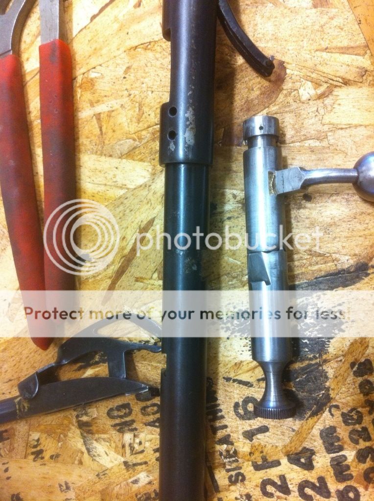

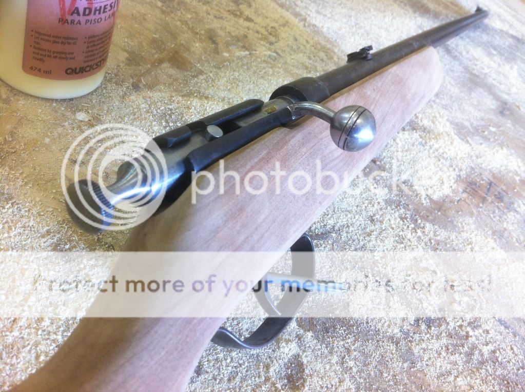

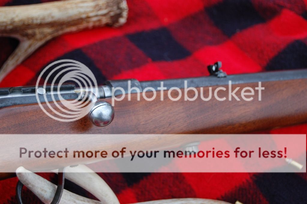

I just finished re-finishing a stock on my dads old decrepit Cooey Ranger. The thing was in a non-firing condition seized shut and rusted to hell (minus the bore for some reason...) and the stock was covered in what seemed like engine grease, mud, and just plain ugly. I chose the tung oil method, and love it.
Here's what it looked like originally.
Here it is after I cleaned the rust and grime and sanded the stock down.
And this is 1 light coat of cherry 325 stain and 10 coats of tung oil.
