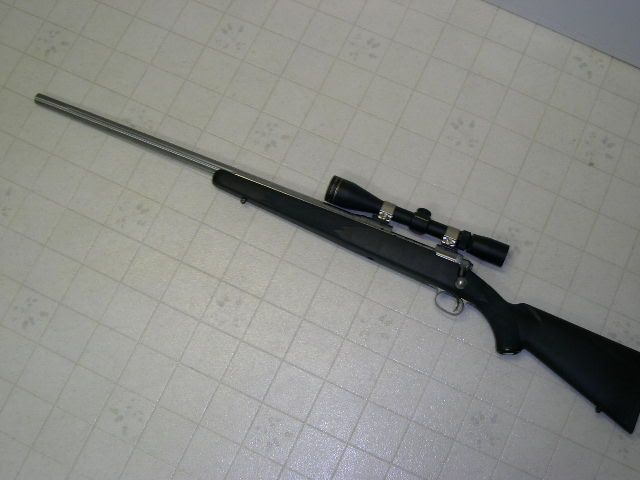

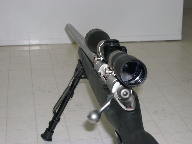

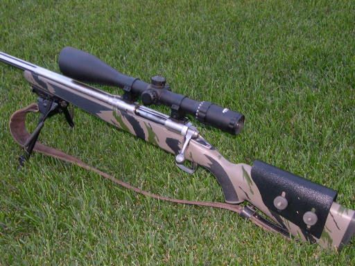

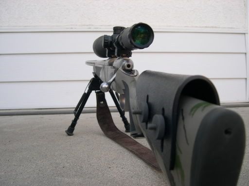

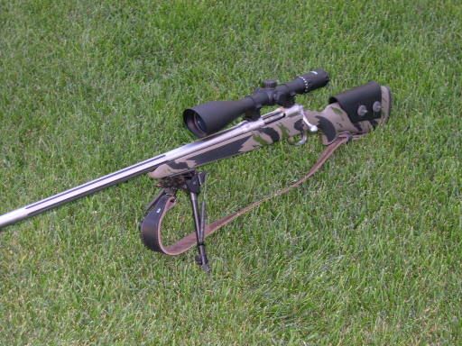

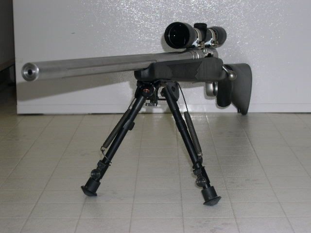

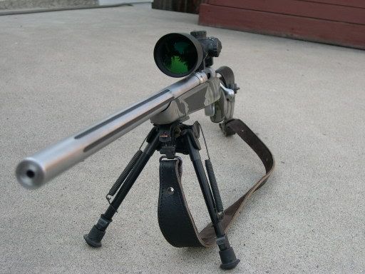

I got sick of my bland factory savage model 12FLVSS in .22-250 and those terrible mold lines on the stock so I finally got off my rear and did something. I bought the Advanced tiger stripe kit from Duracoat and got going. First I sanded down the stock until the mold lines were gone, the basically painted and stuck on the stencils. Quite simple really. Didn't take more then an afternoon. After i got all the painting done I figured with the 26" heavy barrel my 4-12X40mm Leupold rifleman was just not enough scope so I went down to a particular Tactical Rifle shop in Calgary ;) and he set me up with a relatively cheap priced 6.5-24X55mm with a 30mm tube that they had been using on their .50cals. After that was mounted with leupold high rings I noticed that needed a adjustable cheek rest because i was virtually chinning the rifle to see through the scope. So an order went in to Rooster 33 and after a month and a half and numerous calls I finally got the cheek rest and the rest is history.
Only problem now is after numerous trips to busy gopher communities its not groupin so good. The barrel has gotten roasting hot on several occasions and now I fear I've burned out the barrel. Now it only groups sub MOA if you give it a minute or 2 between shots. A good 1500+ rounds have gone down the tube.
Before
After
You may have caused irrepairable damage to the barrel by shooting it to the point of way too hot. Have you de-coppered it lately though? Copper fouling can also do this....regardless, if you have to slow between shots slightly and the accuracy is the same, then just slow between shots.....nice looking rifle BTW...

My guess would be that it just needs a good cleaning,get some CR 10 or Wipe out and get rid of all the copper fouling and it will most likely shoot again.Nice job on the stock.

I personally hate the feel of smooth stocks, nothing to grip when you got winter mits on and are crawlin through the snow too. I found they gave it a stylistic look and tied the rest of the rifle together. Blacked out flutes, black checkering, black scope, black cheek rest.

Yeah I wana get a cheek rest for my HS precision stock to match its tan colour roughly. I wear bulky electronic earmuffs so that could be another problem with my cheek mould so I am gona try slimer ones first. What I am trying to say is Left Hand Pride (even if the ###s have ruined the meaning of the word). Looks pretty! I love it.
