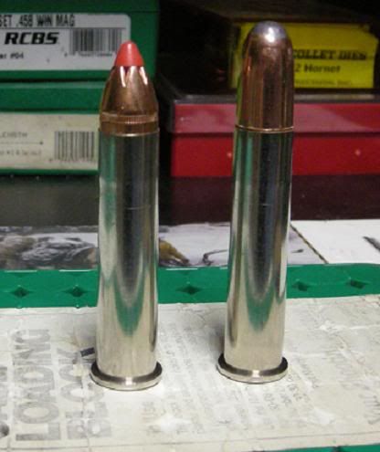

I like nickle plated for a few applications, such as bear loads for my 45-70 camping rifle, where regular brass may tarnish quicker because of less than ideal storage. I also use them for certain specialized hunting loads, makes them easy to recognize. I have annealed the hard nickel plated Remington rifle cases and got good life out of them. Generally prefer regular brass though.
