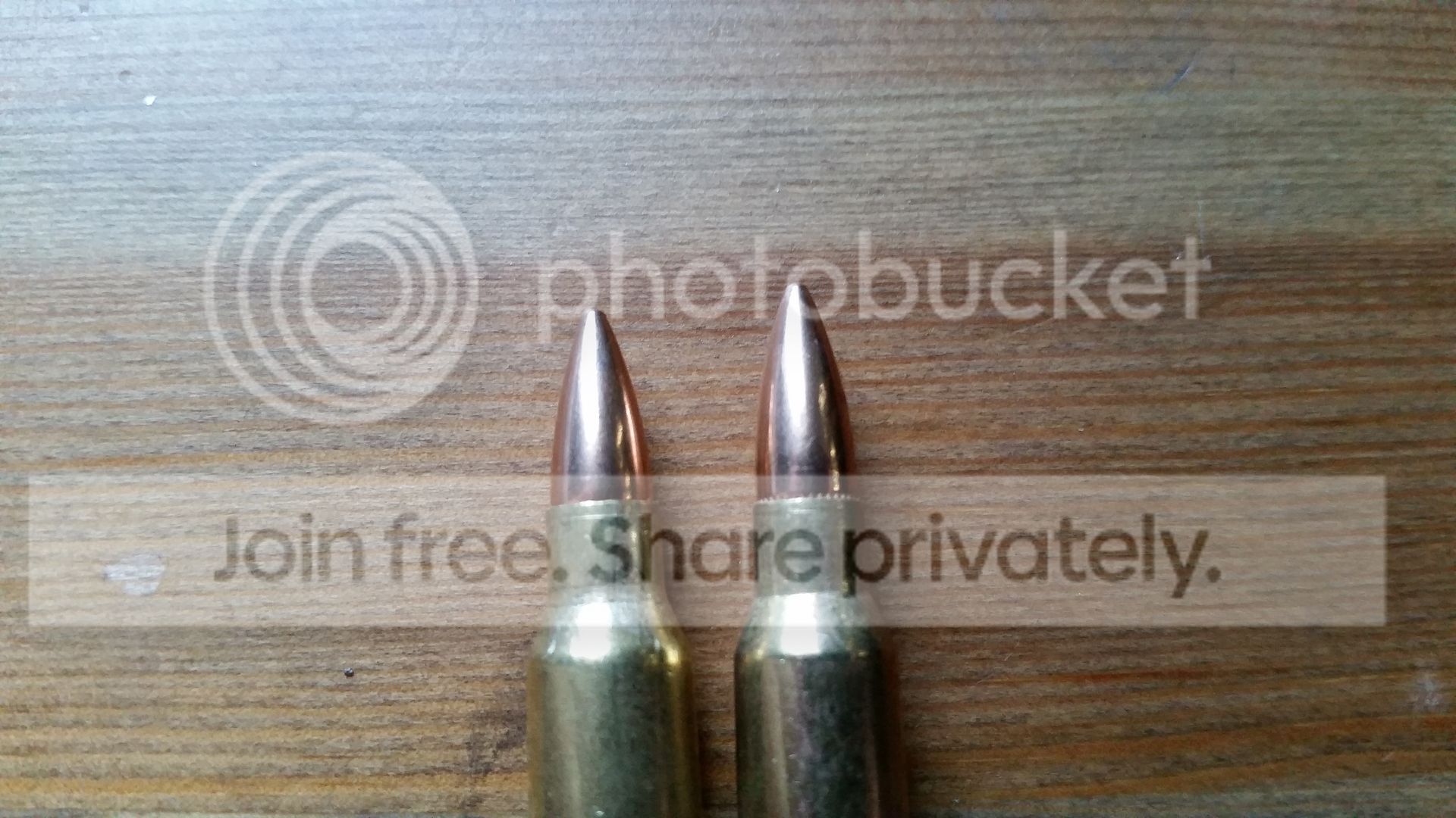

Stupid question but do bullets with a cannelure have to be seated at the cannelure? The C.O.L. in the data i am using is 2.180. This seats them deeper than the cannelure. The bullet in the data is a bar tsx fb 55gr. I seated 10 at the 2.180 then another 10 at around 2.195. Does anyone have a good recipe for campro 55gr with cfe 223?
The cartridge on the left ia 2.180 and the one on the right is 2.195.

Barnes TSX data is for a slightly different bullet. Powder charges are typically lighter as pressures are higher due to the design of the bullet. You can use any 55gr jacketed bullet data for those pills. As for use in an AR, some crimp some don't. Its a good idea though. In order for a roll crimp to be effective it needs the cannelure to be at the case mouth. A Lee factory crimp die swages the neck down into a lock ring that bites the bullet in a taper that is formed. No cannelure is required with that crimping die. As for seating depth, most AR mags are limited to 2.200" for .223/5.56. Theres no harm in seating these rounds to 2.200".

Don't worry about the cannelure. Load to what the recipe requires at least at first (usually max OAL is 2.24". 2.23" is fine for my mags) and remember that shorter seating will increase chamber pressures.

When Im using projectiles with Cann, 2/3 of the cann is under the case, so 1/3 of the cann is expose. from there you can check the overall lenght either by the Ogive or tip, whichever you prefer, try them if they fit on your mag, but usually 55gr.will not have this problem. with a dummy round try loading if it chambers and feel if it extract smoothly one way also to check your sizing. you can also check after extraction if there is a setback on your OAL. You have to use the same components from your loading manual if you want to duplicate their recommended specs. different porjectiles have differrent profiles. About crimping, the general rule- to apply the right crimp if the projectiles have a cann.
