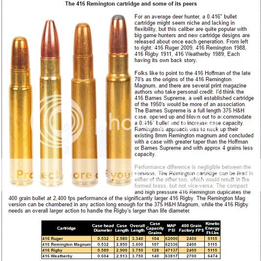

IMR has chamber pressure data (in cup's) for the 416 Rem.Mag. but not for the 416 Rigby. However, using the same powders listed it would vary from their tests for a rifle having a different throat length -
I load 416 Rem.Mag. and 416 Ruger and do the usual thing watching for excessive pressure signs when working up handloads. Current hunting load is a 350gr TTSX bullet at 2450 fps in either using Re15.

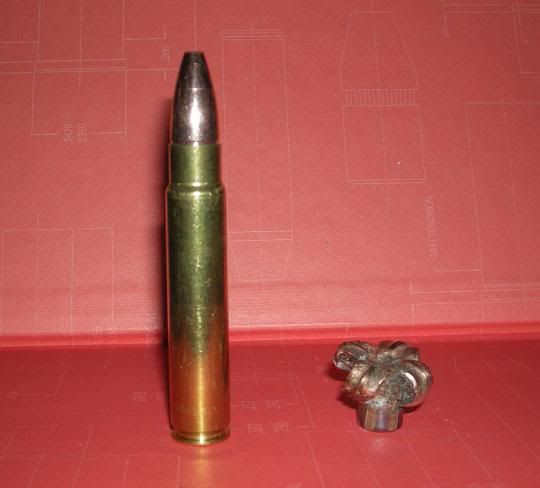

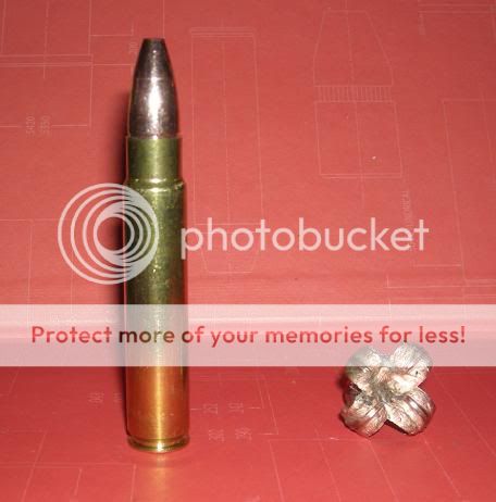

Shown here is a 416 caliber 300gr TSX bullet recovered from a Bull Moose shot broadside through the shoulders at an impact speed of ~2400 fps. I've also used the 350gr TSX bullet on Moose. These have more of a tendency to shoot clear through. High percentage of DRT kills on Moose and Elk using 300 or 350gr 416 caliber X bullets at 2400+ fps impact speeds.

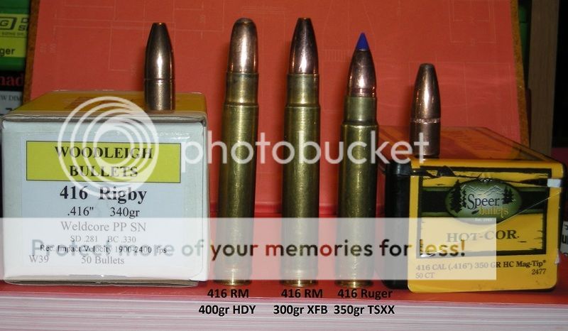

Also good results with the Speer 416 caliber 350gr Mag-Tip bullet on heavy game. Other bullets I load are the Hornady 400gr and the Woodleigh 340gr. The 416's are impressive.
