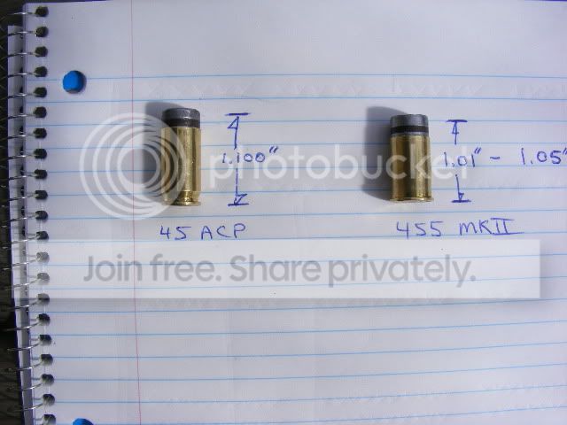

If you are using flat based bullets in the 455 MKII case then look for a bullet style that allows you to seat the bullet as shallowly as possible so that the bullet doesn't use up all of the powder capacity. The picture shows 2 cartridges loaded for use in a MKII Webley 455 service revolver. I load these HB wadcutters with one lube groove outside the case and one inside.
