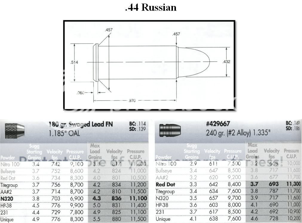

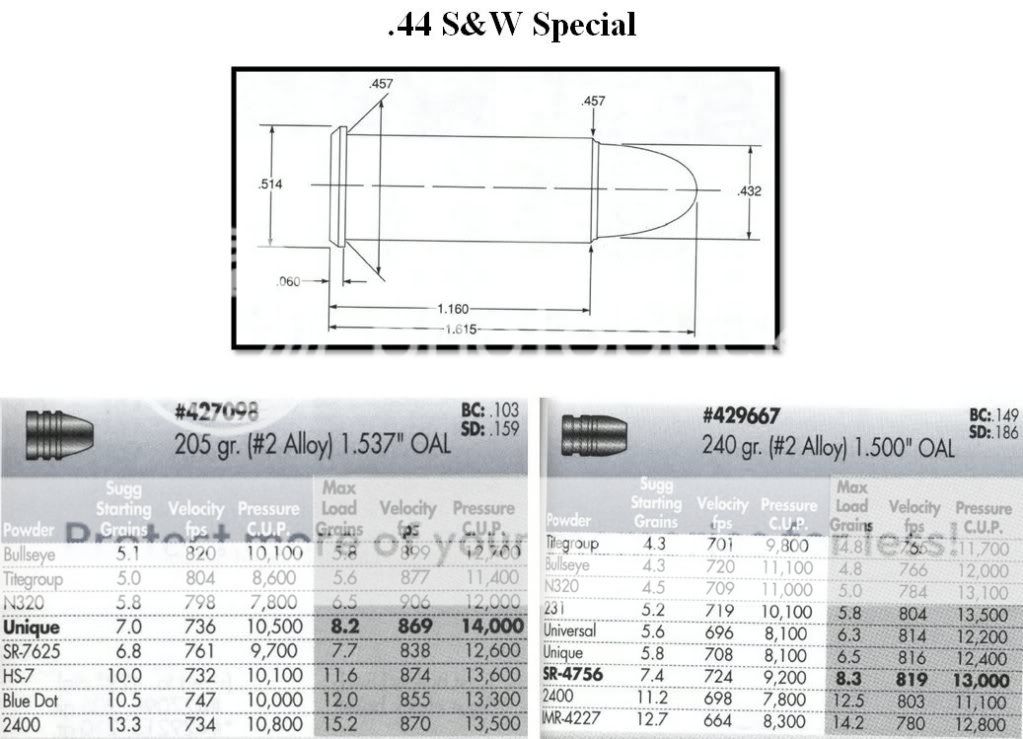

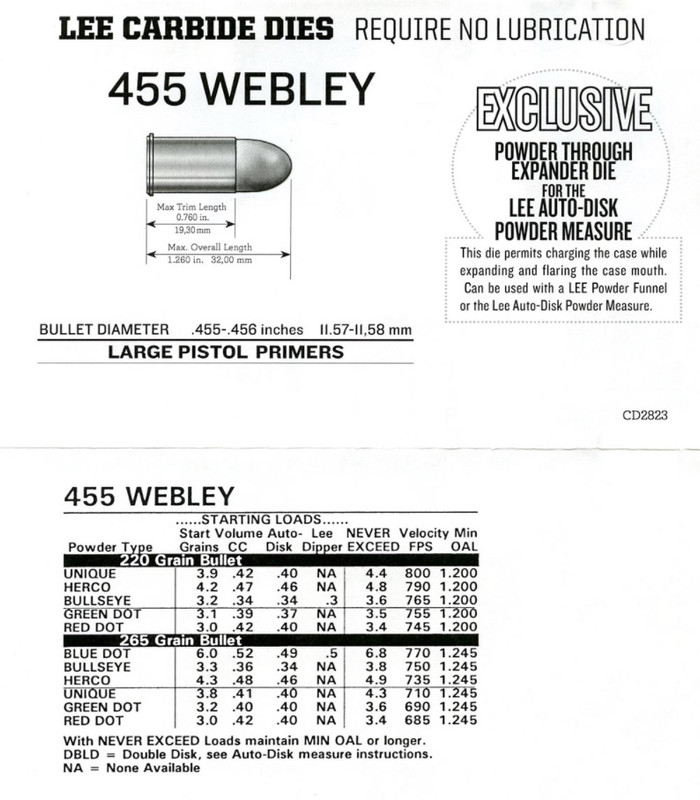

Hey guys,
I just had an "Eureka" thought...
What would you say if we were to share our common knowledge about reloading data for antique calibers? We could make this a sticky and post in this thread our own personal working loads for any particular antique caliber. Loads can be either smokeless or black powder for any given cartridge, as long as the pressures produced are deemed to be safe. Cartridges listed can also be of a more modern design, as long as their intended load is meant to be used in an antique firearm (eg. "cowboy'" loads for 45ACP, 45AR, 44 SPL, 41 Colt, etc). You can also add any other pertinent info than the powder charge, such as: fps, exact pressure, accuracy achieved, etc.
The way this would works is that you'd post a 'Reply' and indicate the caliber in the 'Title' Section. Then you could post tables or descriptions of the loads you use, or whatever else you see fit. I think this would be an excellent idea to exchange pertinent and hard to find information about reloading for antique calibers. Also, before anyone points out the 'wrong forum' argument, let me clarify that I truly believe that such a thread is much more appropriate here than in the 'Reloading' section.
Also... before we get too far ahead of ourselves, let's all be clear on the following, which applies to all of us here:
CAUTION: The information and data contained on the reloading pages is for informational purposes only. Cross-referencing the posted reloading data information for its' accuracy & safety (before use) is everyone's own responsibility.
The end user is solely responsible for EVERYTHING that may occur using this data.
So... anyone interested in this kind of proposal?

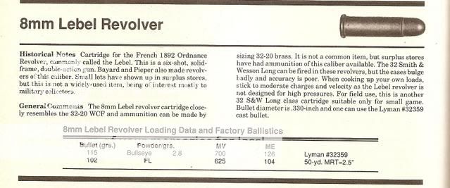

, I've been told that the loaded bullets tare ypically around 120-grain at the upper-end, 115 in the middle and 102 at the low end, so I am curious what an 85-grain bullet might be capable of doing out of that antique French barrel !
