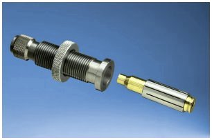

I use a die from innovative technologies that sizes the last little of the case before the belt. Brass was full length sized first. I went from 4 to 5 reloads to over 16 with no signs of problems yet.
